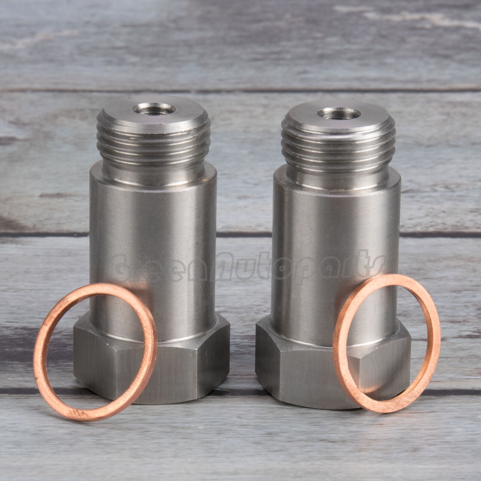

    At worst, get the $110 amazon/ebay cat and an o2 sensor extension. No CEL, and less than $130 all in.

    Don't know if the O2 sensor extension would work with the type of cat test used on the Prius.

    The extensions would keep the car from tripping a CEL with an aftermarket cat. I would be willing to bet a prius with a $100 cat would easily pass any CA tailpipe sniffer test.
