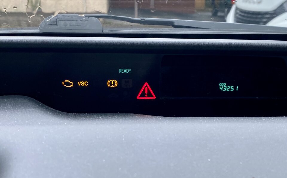

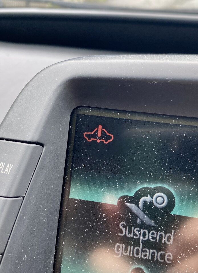

    So this happened this morning, all these dash lights. Used my Autel and got a P0A80 code, replace hybrid battery. No other codes. Have not been having issues with the hybrid battery at all! It’s even been fully green at times on the hybrid infotainment screen. Should I get a new hybrid battery from Toyota, or independent specialist? It’s going to Toyota on Saturday for some suspension issues anyway. There is a local independent specialist near me. I’m in the UK.

    Has Raf Member

    How many kilometers on this vehicle? The first picture in this thread shows the odometer at 43251 (presumably km), but that seems impossibly low for a 2nd generation Prius this many years later. The car has a lot of front end issues, as problems listed include: both lower control arms, a CV axle, struts and springs, a wheel hub (front?), wheel bearings (front?), abs sensor (front?). For comparison, our 2007 had one front wheel bearing replaced a couple of years ago and it is at 227000 km, with none of those other issues. Was the OP's in a wreck or driven into a ditch?

    143,000 miles. No front end damage.
