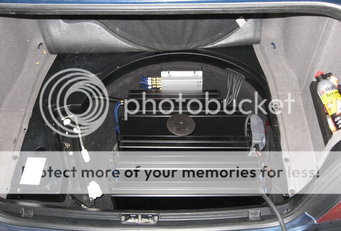

    don't buy an Optima battery. they are a bit overrated for what they are. You are putting in a basic install so no point spending heaps on power supply. And that amp will be lucky to put out 400rms given it's got 40a of fusing.
    I'll repeat: capacitors do nothing in car audio, regardless of A/B or D. Ask yourself why none of the big car audio brands make them. I'm talking from experience, not from unqualified opinion. Go to a SPL competition. Not one of the serious competitors will be using a capacitor.
    No Cap, No Optima, upgraded alternator. No power supply issues in daily use.
