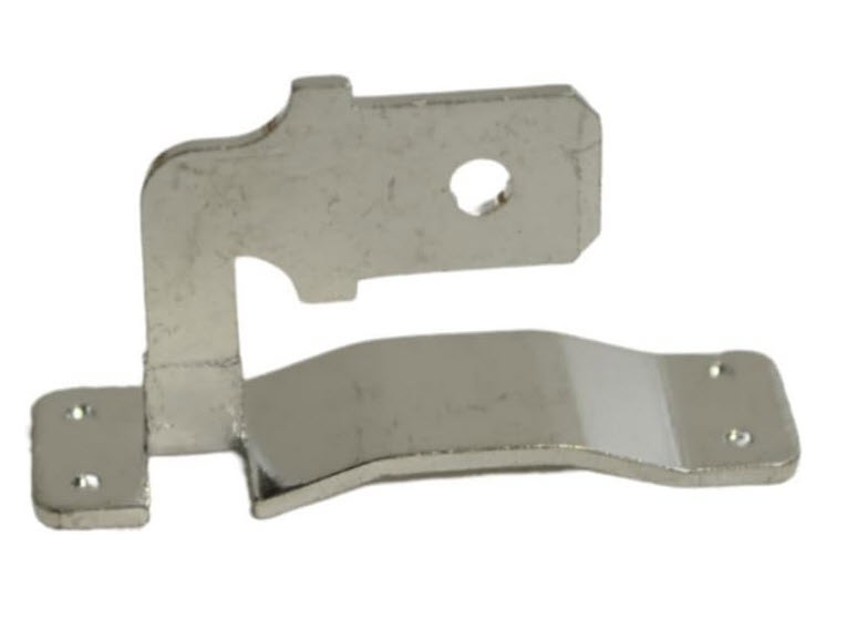

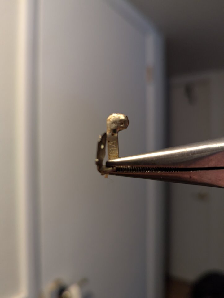

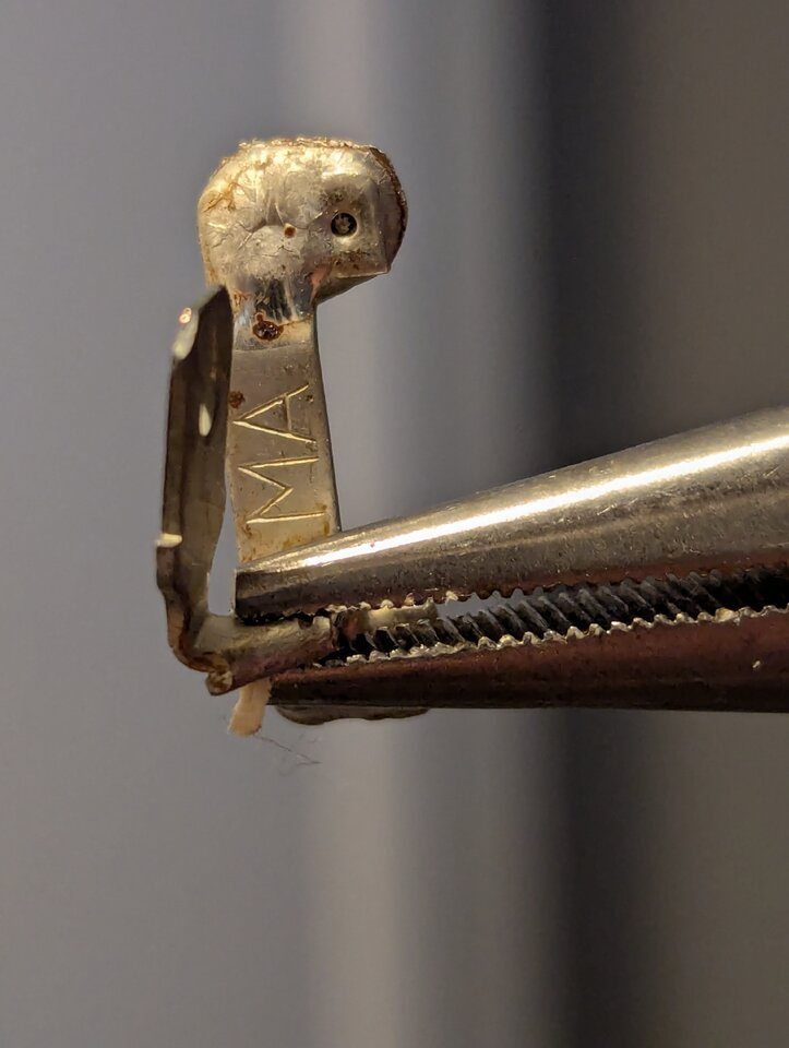

    Thankfully I took a pic of the tab before losing it and this is the closest I could come up with (see link from Amazon and my last image below). The part that goes into the power cord looks the same. I see there are 2 holes in each of the parts that touch the window. This might help it stick with the Atom. The original tab holes are filled in.
    Then I am going to try to flatten the area on the window and buy more Atom. I'll get more than the one use Atom this time.

    The new tab I bought does not have holes as I thought. There are small knobs on the surface that make contact with the window. So now I hope that helps by keeping some of the Atom on the bottom instead of all being squeezed out with a flat surface like what happened with my old one. If I use enough Atom it should stay on the bottom and create good contact. We'll see.
