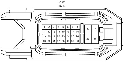

    Thank you. I am missing the row of pins where 35 and 36 would be located on my inverter. Do you, perhaps, have a schematic like this but for the 2013 Prius? My VIN is JTDKN3DU8D5622458. Model code ZVW.

  13. ChapmanF
    28,748
    19,054
    35 and 36 are also shown in my 2010 wiring diagram, and I doubt they moved between years of the same generation.
    Connector A59 looks like this:
    If those pins are missing you might have a continuity problem. :)

    ha! Indeed I might! I was erroneously testing where the red arrows point. I assumed that the numbers at the top and bottom corresponded to the pins at those corners, respectively. (I AM at the right spot, right?)
    So, now I’ve tested 35 & 36 where those green arrows point and I have an open circuit! Now to figure out how to get the lower part of the safety connection off of the inverter?!

  15. ChapmanF
    28,748
    19,054
    Wait, so the inverter connector is the pinny one and the wire harness connector is the sockety one?
    So if you test at your green arrows on the sockety side, you wouldn't expect to see any continuity—those are just two different wires, one leading to the power management control ECU and one heading back toward the battery.
    Now if you test with an ohmmeter between pins 35 and 36 on the inverter, and all the covers are in place, you should see continuity between those pins (well, a resistance of about 2 Ω).
    If the covers aren't in place, you should at least be able to see continuity (1 Ω) between pin 35 and one of the terminal cover sockets, and continuity (1 Ω) between pin 36 and one of the frame wire safety sockets.
    If both of those check out, you'd next look for continuity between the other frame-wire socket and the other terminal-cover socket. Then you can report back just where the continuity isn't.
    Getting all the way down to where the inverter A59 connector goes in is probably a lot of disassembly, and a job for special Toyota thermal paste on reassembly. I wouldn't open that can of worms unless I could find nothing else first.
