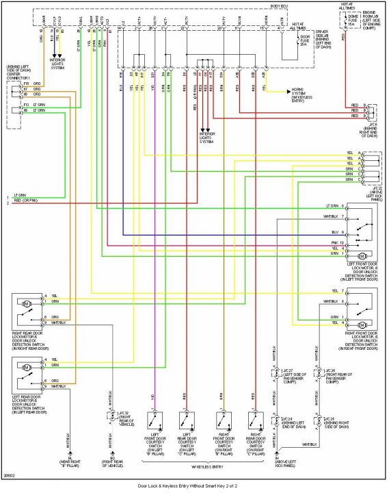

    Below is the circuit diagram of the door actuators. The wiring goes down into the kick panel to a multi pin plug. If you unplug this and supply the actuator with 12 volts if it is working but just reversed you should be able to unlock the door by reversing the supply to the green and yellow wires.
    Hope this helps.
    John (Britprius)
    Another action to take would be to run the window down and remove the weather strip on the outside you may then be able to see the mechanism and operate it with a long hook.
    John (Britprius)

    John, I just wanted to say I gave this a try. I grabbed a new 9v battery and the jumper wires (small wires with alligator clips on each end) out of my electrical tool box, and gave it a go. The yellow and green wires did operate the lock, and reversing polarity did lock and unlock the mechanism. Interestingly enough, if the voltage was left on it would hold the lock closed or open, as in hard enough that I could not manually move the lock lever on the door.
    Alas my problem is between the lock at the latch, so it didn't open the door. Worth a try though, and fun in a geeky sort of way.
