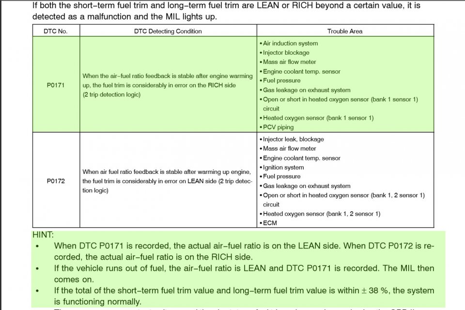

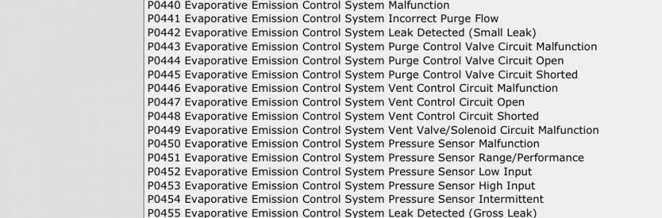

    P0171 is a lean condition. Find a shop with a smoke machine and have them smoke test the intake.
    It will test the breather system, the PCV system, the intake and all the related vacuum hoses.
    Always make sure the brake booster isn't leaking also. Most will leak and cause a stiff pedal.
    Here's some diagnostic data for things to look at.
