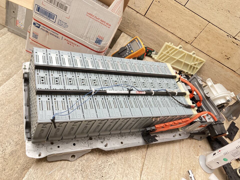

    I'll have to adjust my previous posts a bit.
    About an hour ago, I pulled apart a core battery I received this week in exchange for one of my rebuilt batteries. This is actually a rebuilt battery the guy got from someone on Craigslist from the Raliegh area. It's painted black and has "warranty void if" stickers in a few places on the inside. Has a QR code with a couple numbers on it. Scanning it provides a web address of installaprt.com Wonder who rebuilt it? IDK, but it may be the worst battery ever..... Had to pry the wire harness plug out of the ecu socket and a couple pins came out with it. 50% of the pins are corroded. But, this is at the extreme end of "common corrosion" because this is certainly NOT common. With this much difficulty separating the components, it's blatantly obvious there's a problem and some things are going to need to be replaced. This wouldn't slip by anyone un-noticed.

    Jack sent me his analysis of the 1st Project Lithium Battery failure after shipping it back to him. Here is what he said:
    Hi Joe,
    As promised, I’ve finished the full analysis with the failure pack and I believe I have found the root cause, here is my analysis:
      • Total of blades: 14
      • Damaged blades: #7, 8, #9, #11, #13, #14
      • Blades in good condition: #1, #2, #3, #4, #5, #6, #10, #12
    At first glance it looks like #13 and #14 are the culprit, however after a full cycle test on all 14 blades, #7 stands out due to it’s first lithium cell has a much lower voltage constantly (see below 2nd picture). This is what we call a SD cell (self-discharge cell) that constantly losing its power.
    I believe what happened was #7 blade losing its voltage, your Prius see the delta voltage over 1.2v and decided to charge up the whole pack in hope that the #7 can recover and balance itself, unfortunately that #7 continue to lose power and trigger more and more charging cycle and eventually overcharging blade #7, 8, 11, 13, 14 following by the error code. The #13 and #14 are merely the victim and #7 is the defective bastard that causing the chain reaction.
    Best Regards,
    Jack
    Jack has offered nothing but integrity and grace dealing with my initial Battery Pack failure. Even if your Project Lithium pack does fail... His customer service is top notch, and he will ensure whatever issue you have is taken care of. Thanks again @jacktheripper!
