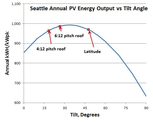

    "Optimum" tilt angle depends on one's goals.
    The old most simplistic rule was to have the tilt match the geographic latitude, which intuitively gives square-on orientation at the Spring and Autumn equinoxes, and equal reduction at summer and winter solstice. But this doesn't account for seasonal differences in day length and cloud cover.
    An off-grid system will want to tilt higher for winter production, then will be throwing away considerable summer excess. An on-grid system aiming for maximum annual production and carbon offset will want to tilt lower for better production on long clear summer days, at the expense of short cloudy winter days that have lower production anyway. While the day length is easily computable from geometry or astronomical almanacs, the weather and cloud cover are empirical things that vary enormously by location, and must be measured. NREL has access to decades of solar and weather data for very many locations, and now good models to interpolate for other areas.
    For my system, I ran the old-version PVWatts calculator with tilts covering the full range. My 5:12-pitch roof is slightly less steep than the 'best' angle for my location, losing just a few percent of theoretical production. This is so close that the complications of using a different angle weren't worth the effort and wind-loading risks:
    Other locations will get a different curve. Even at the same latitude, different locations will get different curves due to different seasonal cloud coverage.
    A system mounted on a frame in the yard isn't constrained by roof pitch. It could even be somewhat easily built for adjustable pitch to adjust for different seasons, if anyone wanted to put that much effort into it.

    I was wondering about this exact thing this afternoon. Made me wonder if there's a trick bracket kit or something that would let me tip them another 10-15° twice a year.
    Though if the curve in your graph is typical, might not be worth it since I'm quite close to 40°N anyway.
