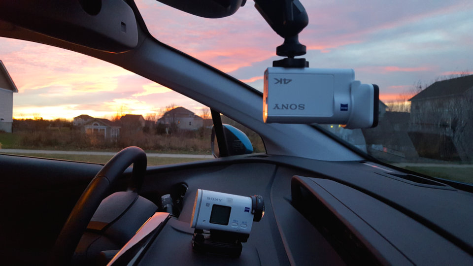

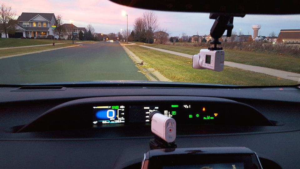

  15. john1701a
    john1701a Prius Guru
    Jan 6, 2004
    12,840
    5,312
    Here's the dual camera setup I use for filming those videos that have been recently shared:
