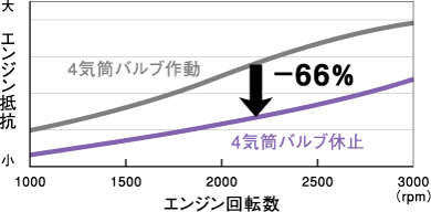

    Anyway, following chart by Honda's study shows 66% energy loss reduction on valve closing came from following page (Japanese only).
    CIVIC/CIVIC HYBRID
    Ken@Japan
