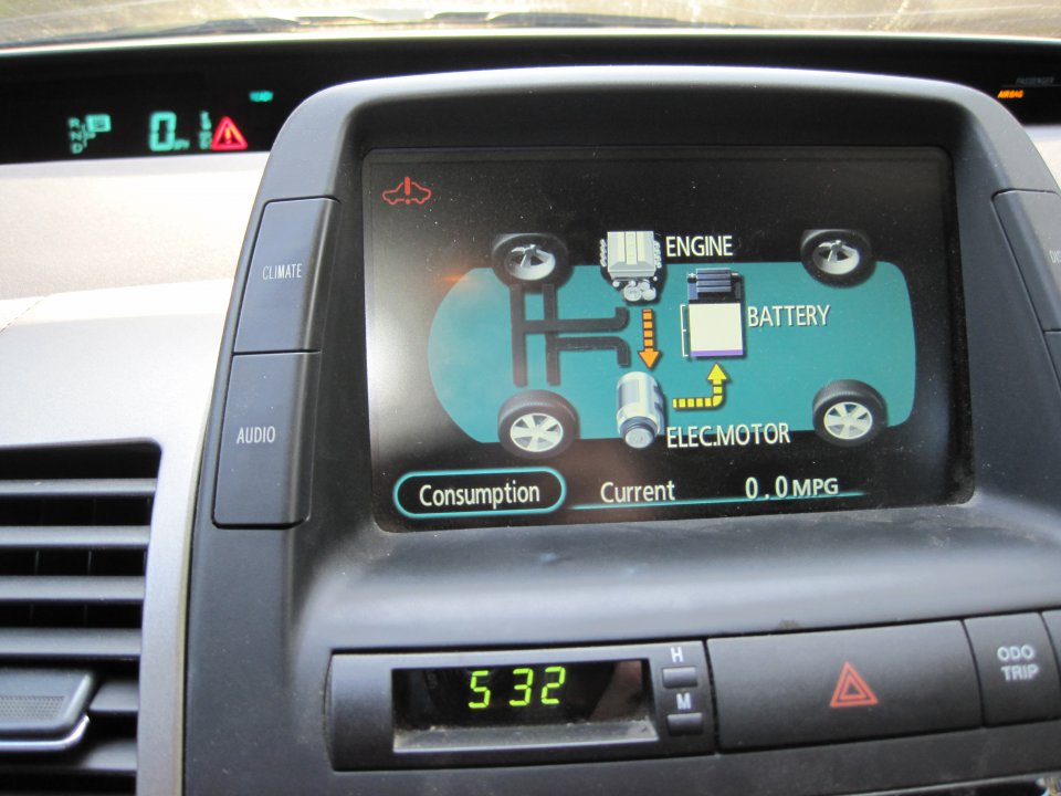

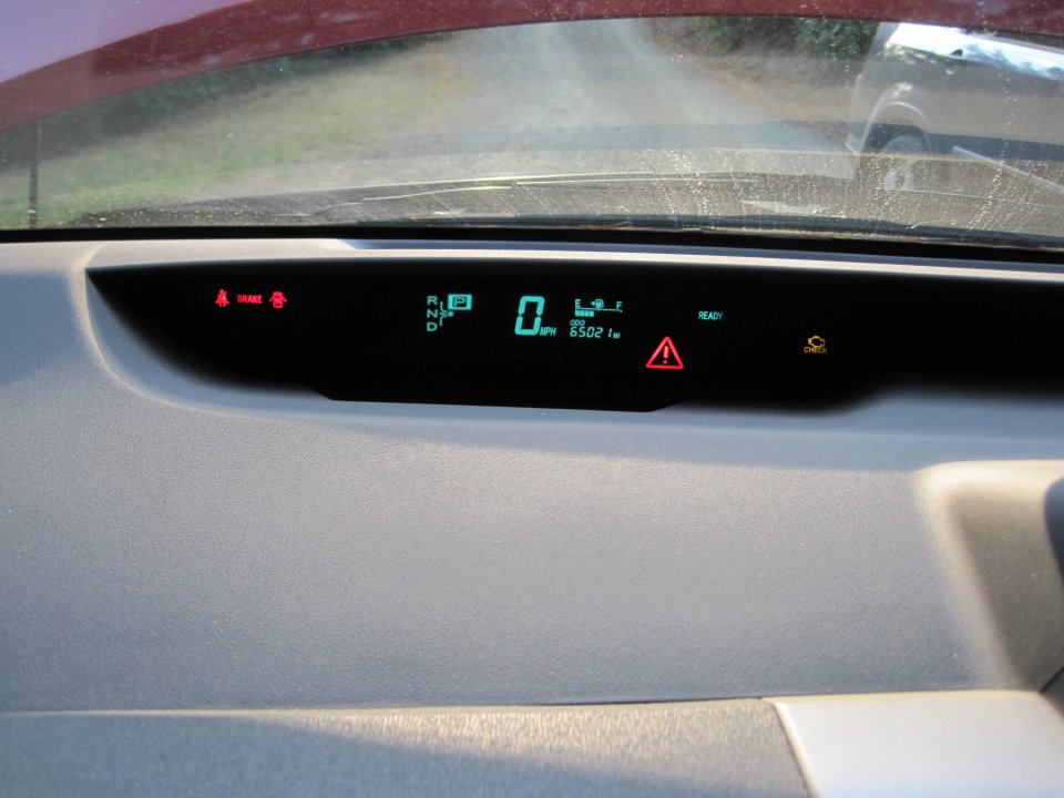

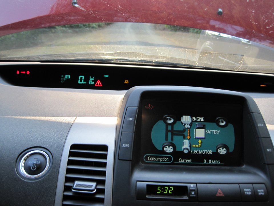

    Well, went back down....it was a bit of a .... well ... did not go that well. I am really scared I will damage something beyond repair, even by turning it on....
    I managed to lose my camera and the prius key.... took a lot of searching and I found them both ... but that should tell you how nervous I am about this.
    I did the ready ign-off and the reading AT THE BATTERY was 13.9.
    I put about 50 ounces of coolant in before it came to the top.
    I took pix. Quickly. Again, very scared. I forgot to look at the inverter pump....that's how shook up I was.
    Pix are below.
    I will go down in a bit and look at the inverter. Not looking forward to it....
    OH, finally, the ICE did run when I went down this last time. Maybe it was running before....I really was panicked with the big red triangle and all as I was driving up....
    one last thing. When I parked, the battery meter had just hit purple and was on two bars. When I went back down and started the car just about 15 minutes ago, it was at one purple bar. But, after I checked the battery voltage and took photos, I noticed that it had went to TWO bars again.
    Don't know what is important, just reporting what I saw....

    It sounds like your car has two problems, both of which need to be addressed immediately:
    1. The inverter coolant pump is not working based upon your observation that you do not see fluid turbulence in the inverter coolant reservoir when the Prius is READY. That needs to be immediately fixed. I have posted previously on how to replace this pump - since you already had it done once for free via recall, your local dealer will charge you a few hundred $ for that repair - unless you had that recall done less than a year ago in which case you might argue that the part should be covered under the normal Toyota 1-year parts warranty.
    How to Replace the Inverter Coolant Pump | PriusChat
    2. Look at the engine coolant pump for coolant seepage which is the most likely reason for the low fluid level in the radiator. Other reasons would include a leaking radiator hose or the radiator itself, but those are relatively low probability events.
    If the engine coolant pump is the issue, my thread here may be of interest:
    How to replace engine coolant pump and thermostat | PriusChat
    Next week, I'm planning to replace the engine coolant pump on my daughter's 2007 which has logged 72K miles. She was quoted $600 by her dealer in south Orange County (CA) to replace it and sent photos documenting that the pump actually had a bad leak.
