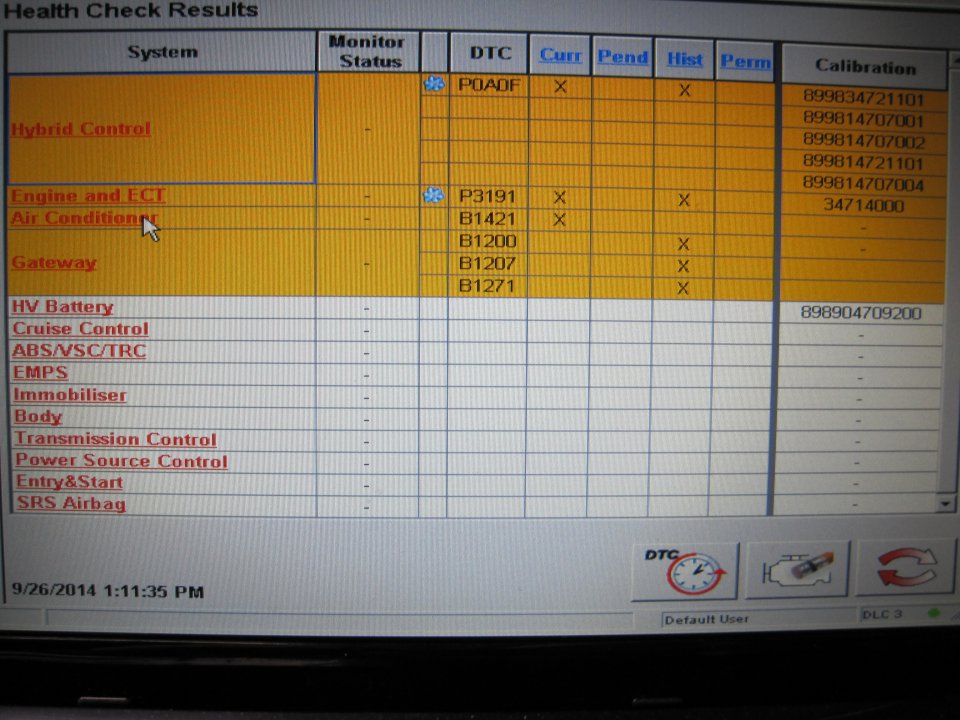

    PRIUSDTC.jpg FINALLY got the mini-vic to work....not fun.
    I have the following codes:
    Hybrid control POAOF
    ENGINE ECT P3191
    Air Cond. B1421
    Gateway B1200
    B1207
    B1271
    Those mean anything?
    I have attached a photo of the actual "screen" from TechStream

  19. valde3
    valde3 Senior Member
    Jun 28, 2014
    2,002
    751
    Finland
    P0A0F - engine failed to start
    P3191 - Engine Does Not Start
  20. uart
    uart Senior Member
    Sep 7, 2009
    4,220
    1,212
    Australia
    Yep. P3191 is "poor engine power" and POAOF is "engine failed to start". So these two are definitely related to the problem you experienced.
    I'd be taking a close look at the throttle body, as well as the ingiters and plugs at this point. Your problem seems to be intermittent, so it would be a good idea to check all the ingiter connections etc. Also given your reported problems with mice, it would be a good idea to inspect the wiring as far as you can for rodent damage.
