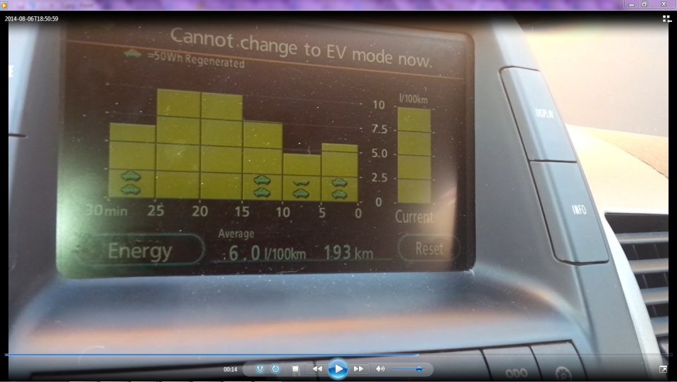

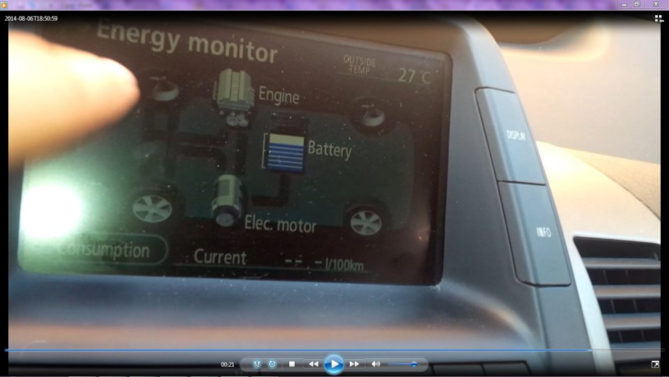

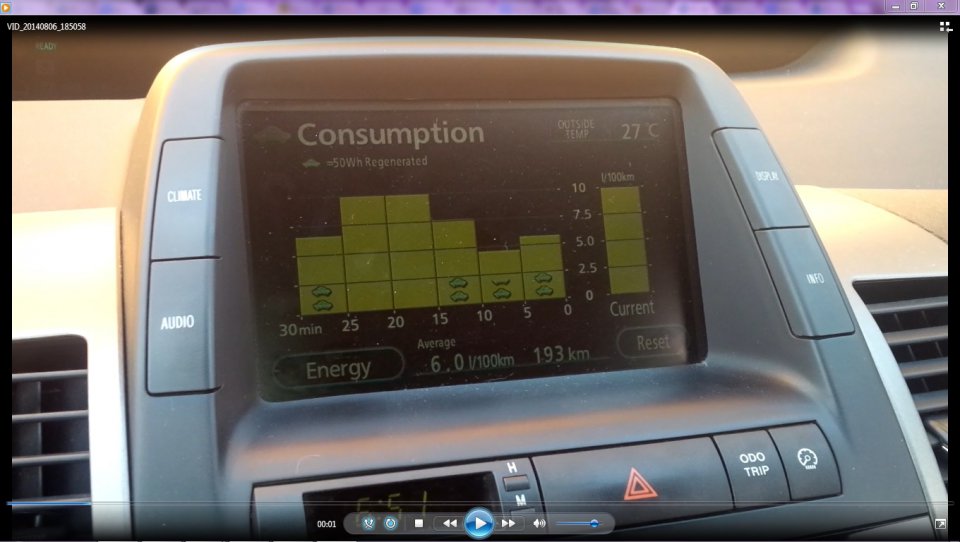

    Hope you can give me an advice because my 2nd gen Prius started to act strange after 6 years.
    The problem I noticed is that the ICE is running too much, for example even when I am stopped after 30-40 minutes of continuous drive (no traffic jam), hot weather (about 27 C degrees, 80 F), battery showing 7 lines.
    Even when I try to enter EV mode I am not allowed.
    Please see some pictures below. All 3 made when stopped. In the past the ICE was off in these conditions.
    Maybe the ventilation of hybrid system is bad ? I see no other explanations.
    I am looking forward to your answer.
    Dan

    I know the stages And I know I have to wait 10 seconds for the ICE to stop. But îs keeping running for at least 3-5 minutes.
    12 V battery replaced 2 months ago, I have measured myself 1 week ago And îs ok.
    ÃŽs something else.
    Dan
