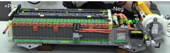

    Different and confusing interpretation I found on several post to identify the modules-blocks numbers that the apps like Dr. Prius shows. I believe the rule of thumb is to start counting from the negative pole, which in my 2011 gen 3 prius is passenger side. Is my understanding correct?
    If that is correct, I am wondering if the block 5 reported by Dr. Prius as the problem, is related to the safety disconnect (black one) system. Maybe the resistance of the long cable and the switch instead of a bus bar, makes the difference to be the one reported.

    There's some information missing from your post: it seems you are looking at some report from Dr. Prius that has you concerned about block 5. Can you share what you are seeing there?
    In the photo you have shared, the end of the battery marked "-Neg" is not the end I would call the Driver side. But your profile also doesn't show your location, so it might be the Driver side in your region.

    I am sorry, my mistake... it is passenger side.
