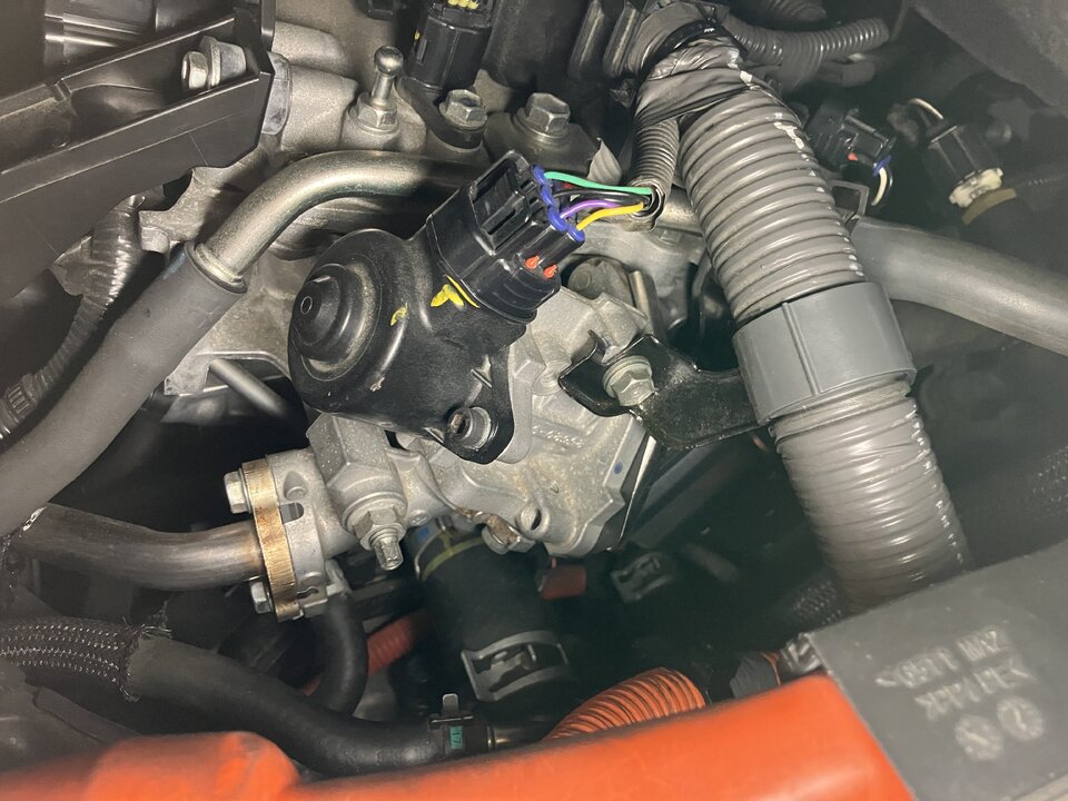

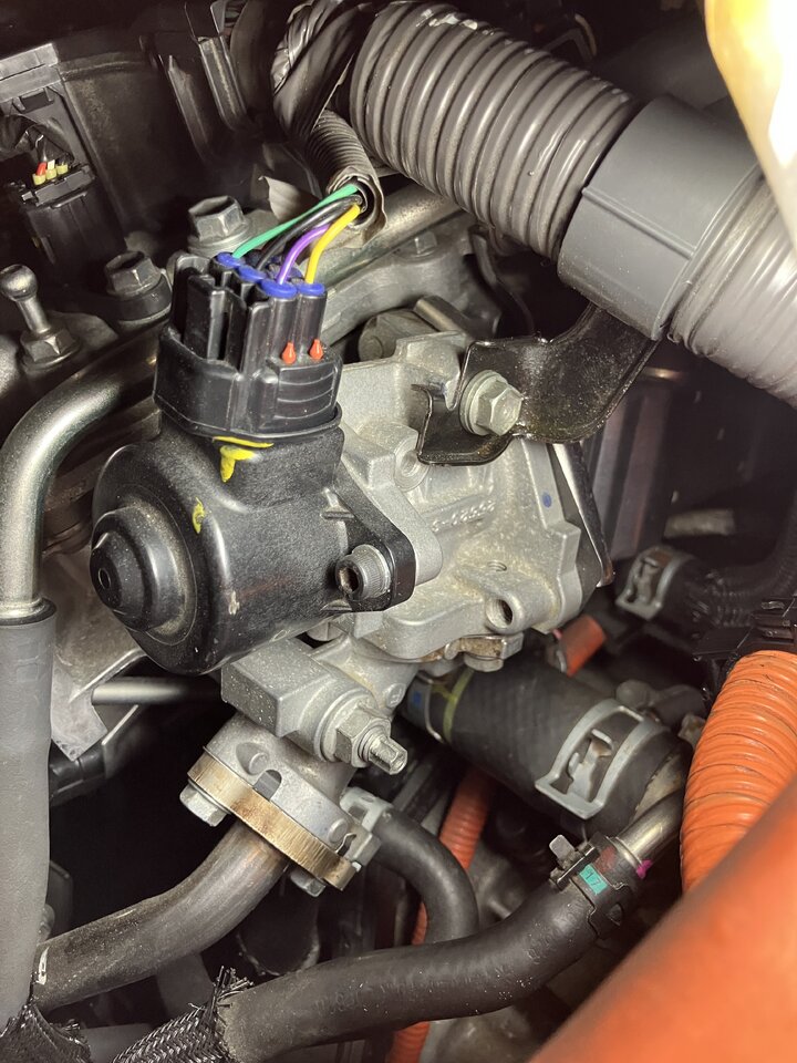

  14. ilkehylke
    ilkehylke Junior Member
    Jul 7, 2023
    Finland
  15. Mendel Leisk
    61,521
    42,332
    That might be a gen 4 EGR system. Pics of my 2010:
    Versus yours:

    I googled the part number on the sticker on the valve assembly, which seems to be for the 3rd gen. Is the EGR different from that?

    There’s something odd in your pics. The pipe between EGR valve and intake manifold for example, seems to flair out the diameter just beyond the flange connecting to the valve. Maybe. Or I’m losing my mind.

    Yeah I’m not sure if it’s gen 4 EGR. Tip off would be at the connection to exhaust: the exhaust manifold has pipe that runs sort of back to front to mate up with the EGR cooler, and to connect to gen 4 cooler it requires some heat-and-bend adjustment. It’s hard to see, way back there with wiper in place. If that connection looks “factory”, ignore me. ;)

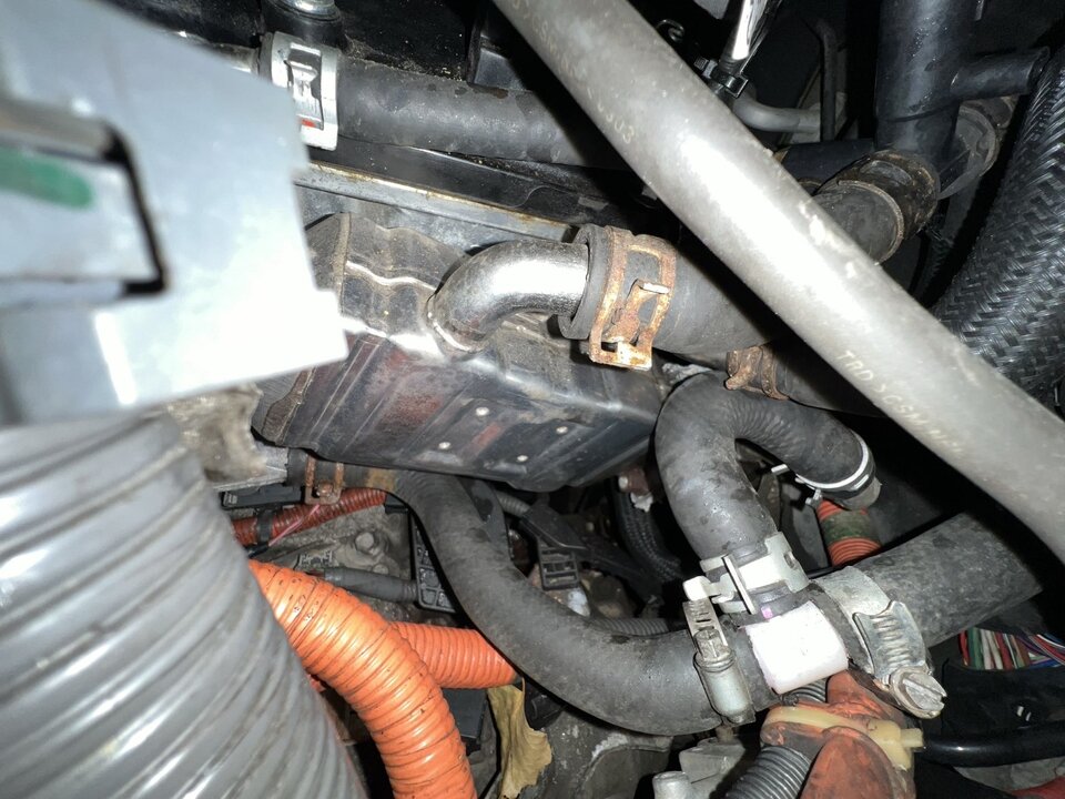

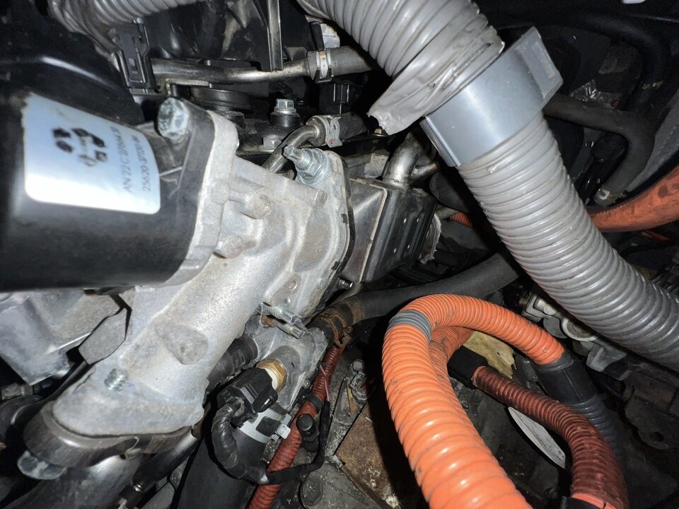

    Returning to this farce of a car repair now that I'm free from other duties.

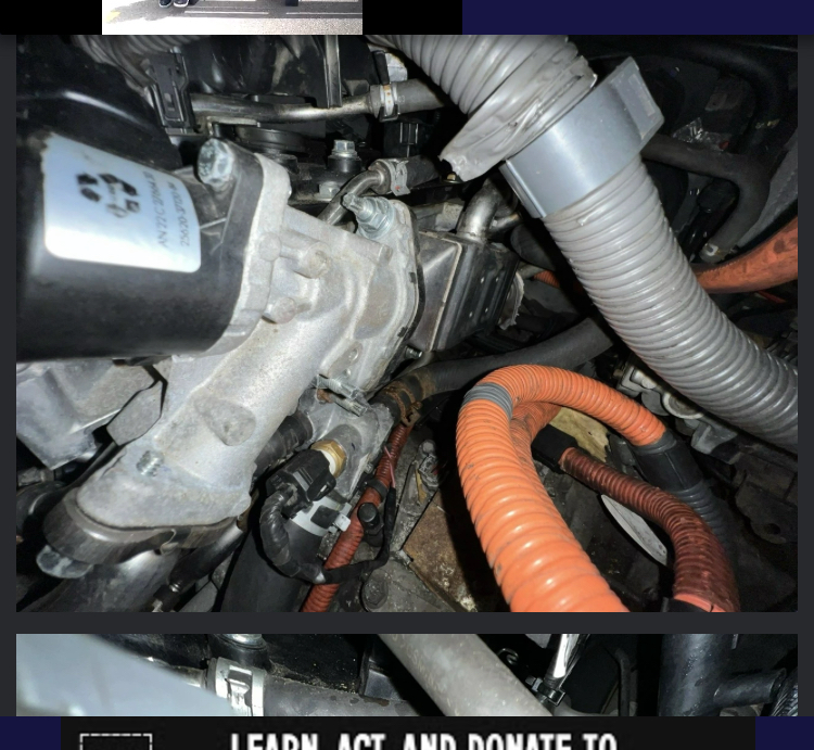

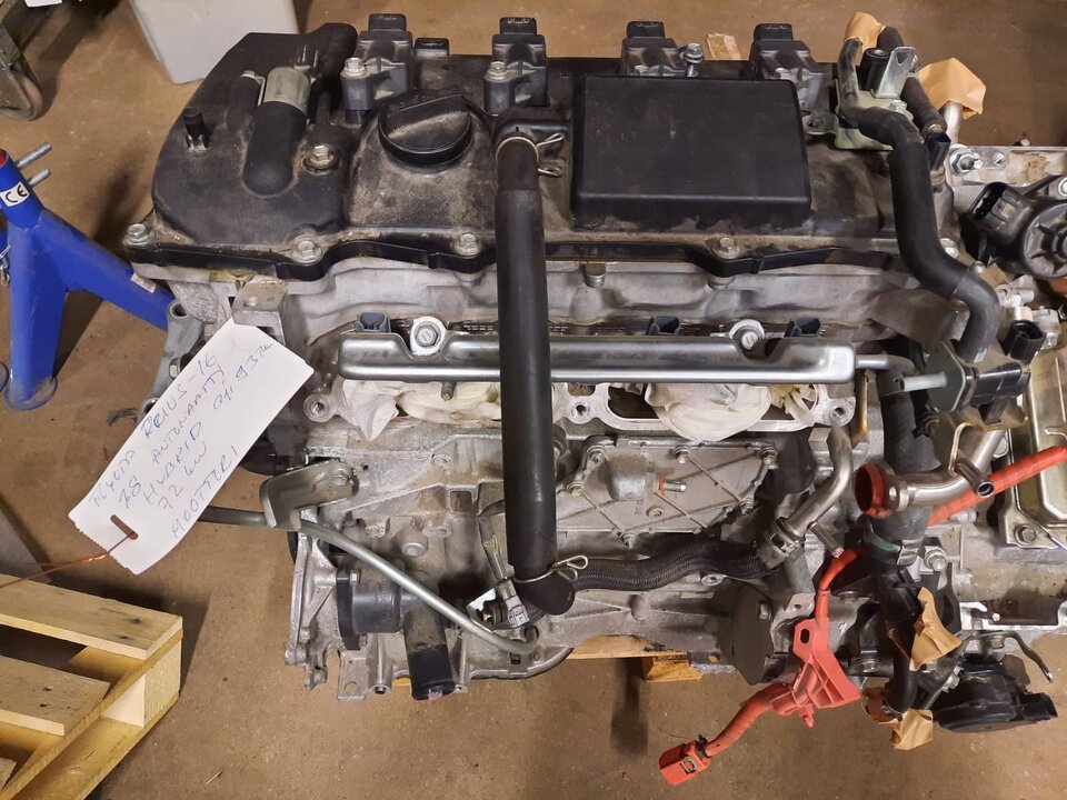

    I'm pretty sure the shop didn't follow my explicit instructions to reuse the old EGR when swapping out the engine. First two pictures are what the place that sold me the replacement engine sent me, other two are post-installation. The EGR looks exactly the same.
    Are all my problems solved magically by just ordering a new 3rd gen EGR and swapping them?
  19. Mendel Leisk
    61,521
    42,332
    Off top of my head the EGR components look different, and the following crop of your last picture does not look stock, considering the screw clamps, and the way the elbow hose is bent, maybe touching the cooler.

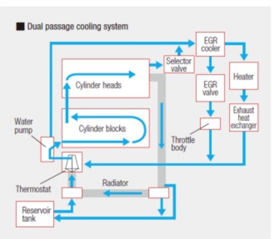

    You need the gen3 egr system. Most people use the 3rd gen intake as well. The most successful swaps used the gen3 head. This allows gen3 intake, egr system, throttle body and controls to work properly.
    I call it the Frankengine.
    Cooling system changes were required. A gen4 egr valve has coolant lines a gen3 does not have. A gen4 jdm engine has a coolant selector valve a gen3 has no controls for since that valve does not exist in a gen3.
    There is no telling how your shop plumbed up the gen4 requirements using a gen3 cooling system.
    Gen4 jdm cooling system
    If it were me, to stay simple, I would try to physically block off the egr flow to the intake (without creating s vacuum leak) and see if that cleared things up. Then to solve the p0401 figure out how to custom fit the gen3 egr system including the egr cooling lines into your gen4 intake. I believe others had to fabricate the connecting pipe.
    It's a mess that has only one decent configuration which hybrid pit sells as their best engine replacement. Gen4 block with better cylinder cooling, pistons and geometry where the head fits, a modified head gasket to somewhat match a gen3 head (allowing all gen3 intake and egr pieces to fit) topped with the gen4 cam assembly and valve cover.
    Pretty soon you begin to understand why the gen4 engine into a gen3 strategy has quietly faded away.
    I recommend a hand picked jdm engine for value and reliability or a quality hybrid pit gold package rebuilt engine.
