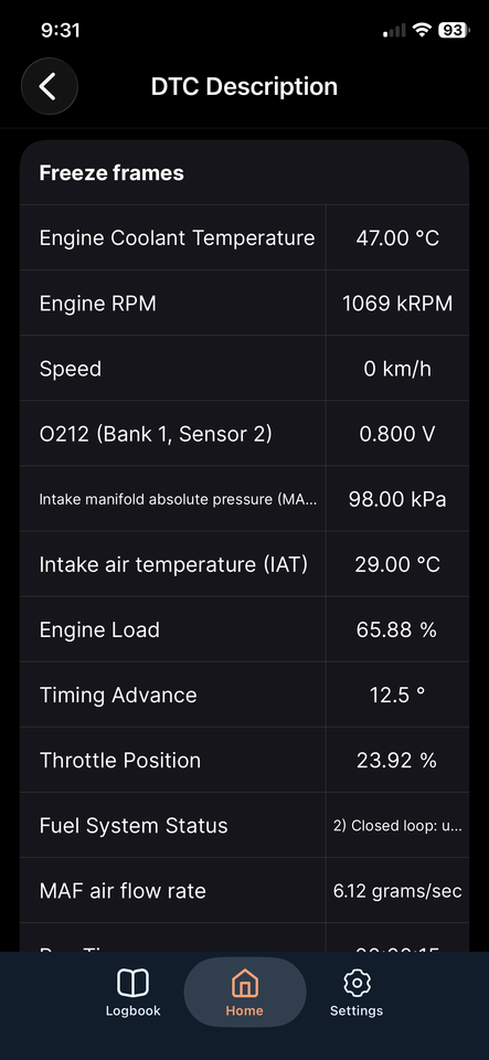

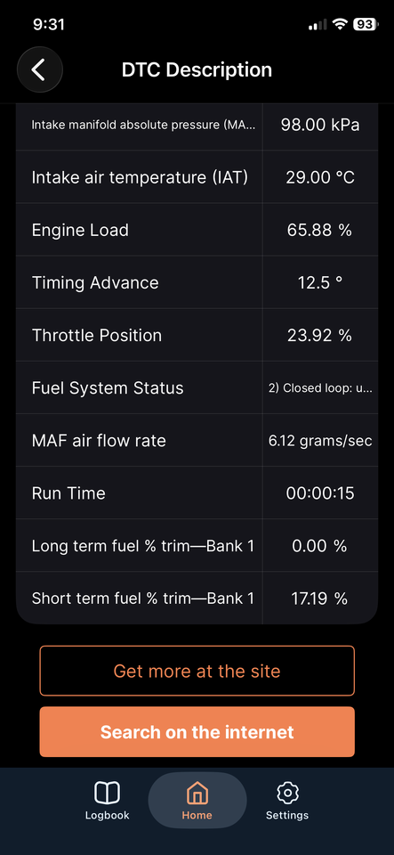

    The scanner they used was an Innova 5160rs. I used Dr Prius and Auto Doctor to read live data. It has 203.7K miles on it.
    At a cold start, long-term trim shows 0.00% and short-term trim shows 17.19%. MAF air flow rate is 6.12 g/sec. (see attached)

    I am guessing that the long-term fuel trim was 0.00% because you had disconnected the 12v battery. The car only ran for 15 seconds for the short-term fuel trim to get to 17.19%. If possible, drive the car for 5 to 10 minutes and check the fuel trims again. Stop clearing the trouble codes and disconnecting the 12v battery.

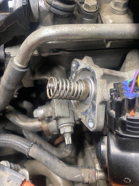

    I took the actuator motor off the EGR valve (see attached picture), and the exposed rod/pintle in the middle is completely frozen. It won't move up and down at all.
    Has anyone had success unsticking a fully seized valve stem like this, or is the internal mechanism toast, or it that normal?

    The cheap chinese ones don't work correctly. Basically, none of them do, except the oem
    from Toyota. Electrical parts like that for the Prius are best gotten from Toyota.
    If you take the valve off, you can spray it with carb cleaner, that will help free it up.
    Since you already have the cover off, you can spray around where the valve goes into the
    guide, and gentry tap it with a hammer to get it to move. More carb cleaner.... repeat until
    it moves freely...

    It was definitely the stuck EGR valve! I used some carb cleaner to finally loosen it up, and the car is running perfectly now.
