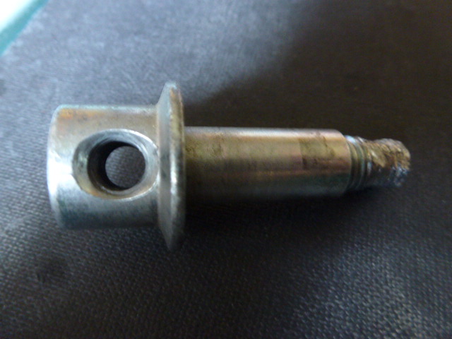

    Thanks Shu for the information. I have also just had to deal with this issue for my 2005 prius. Unfortunately the nut would not come off and I ended up destroying it with cold chisels (not easy - there is limited access). I also damaged the thread of the bolt, and had to find a replacement. One thing I noticed is that the replacement bolt and nut was coloured bronze (same as in Hobbits 100k maintenance picture), while the original was coloured silver (or grey). So a different metal? I was wondering if 2005 pri might be more susceptible to this problem if a different metal was used?

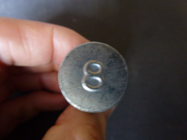

    I would recommend not damaging the bolt! the bolt is not standard - it has another thread through the
    head where the tension adjustment bolt goes - to get a replacement through a toyota dealer was over
    $AUS100 and ex Japan (have to buy the whole idler pulley assembly). I was lucky to find one at
    the wreckers (still had to pay for the pulley, but only $AUS30). Its got an '8' written on the head. No WT or
    JH that I could see.

  19. Wandering Elf
    Wandering Elf Junior Member
    Jan 18, 2013
    Perth, Western Australia
    Hi Rude person's,
    Thats really nice of you, although I hope no one else ever has to replace this bolt. Here
    are some pictures of the damaged bolt. I don't have any technical drawings, its about 55mm long.
    Hobbit also has a picture of the whole idler pulley assembly at:
    100K maint - 2
    (scroll down almost to the bottom).

  20. Mike500
    Mike500 Senior Member
    Mar 1, 2012
    2,593
    767
    Dean,
    Instead of a specially made bolt, a block of steel or other material can be made that's drilled at 90 degree angles. This is a common adjustment method used for pulley adjustment over the years on many cars. What is the threading size on the cross drilled head?
    On the alternative, if there is space, the bolt can be threaded from the back into a lathe turned and threaded sleeve with a square head for the piece that needs to be cross drilled and threaded.
    These are just a few methods of making workable replacement parts.
    It helps to have a machine shop and extensive tooling available.
