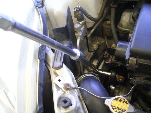

    Yeah that nut was definitely a *lot* harder to loosen than I was expecting, especially considering the fairly modest torque specs for that fastener.
    I started with a long pattern double box end wrench (ring spanner) and soon realised I'd need more. Came back at it with a nice strong 1/2" drive hex socket and breaker bar, and realised I'd still need more. The picture below is what I finally ended up using to shift it. :)

    well that one I used was a bit shorter, but that long attachment will definitely do the trick. :)
