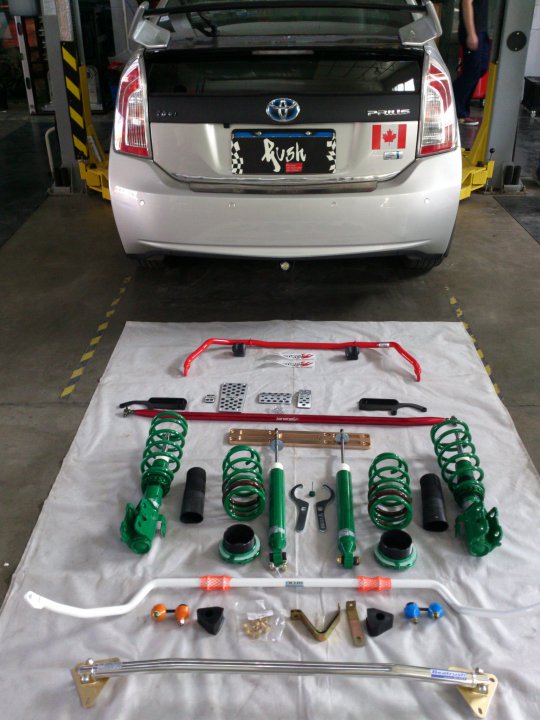

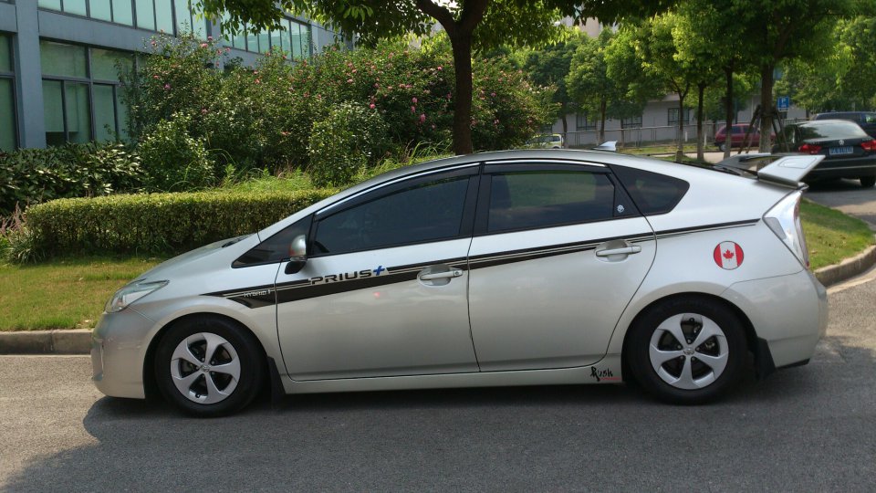

    My 2012 GIII with TEIN Street Advance,Tanabe bars ... etc.

    Nice. How do you like the street advance? I'm hoping full soft setting is close to stock. Still haven't gotten around to installing mine yet.

    Thanks. I haven't actually checked the "full soft" setting but set it at about 2/3 hard which allows me enjoy its handling. As it is 16 section hardness adjustable, you would like to do a lot of test drive to find the setting suits your driving style most. It is simply preference.

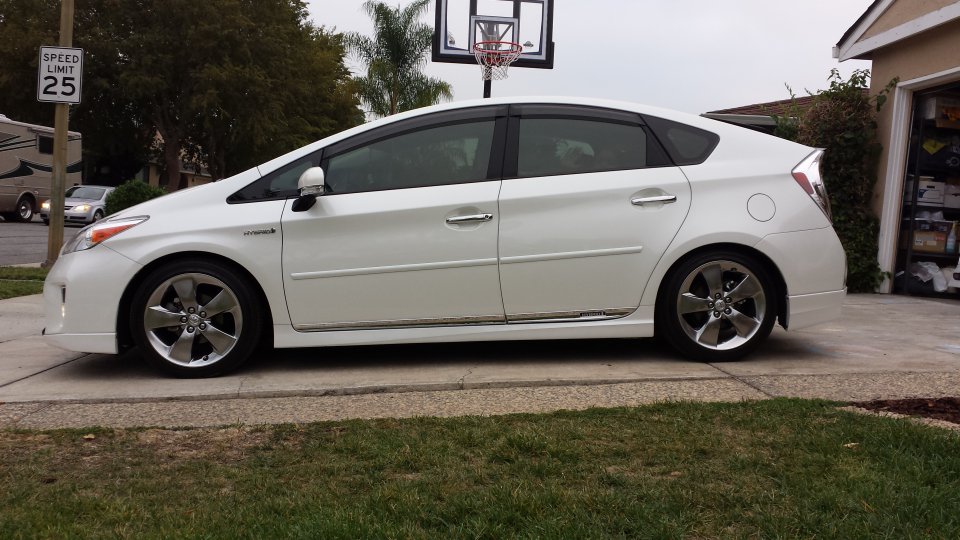

    20141010_074133.jpg Finally decided to drop the Prius with the TRD Springs. Letting the springs settle. I will have the alignment done next Tuesday. The car drives straight and no play on the steering wheel. I am still worried about the alignment. I hope everything are within specs and can be adjusted to within specs if not within range.

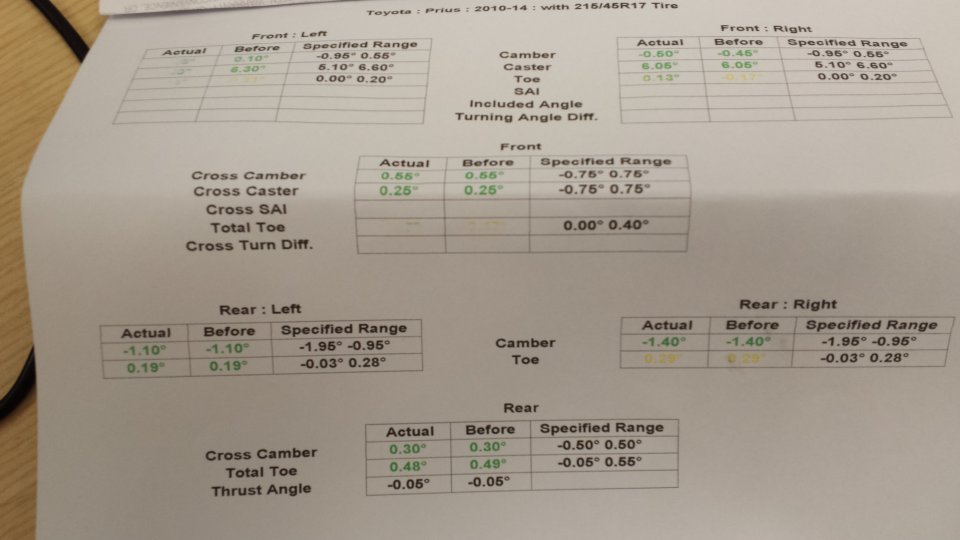

    Finally had my alignment today. Front alignment were within the given tolerances. Left rear was also within tolerance. The right rear toe was outside the higher end tolerance of .28 degrees. It was at .29 degrees and obviously it was non adjustable. So right rear toe off by 100th of a degree. Dealer says it was nothing to worry about because it was minimal and insignificant. They believe it came out of the factory this way. They said tires should still wear normally.
