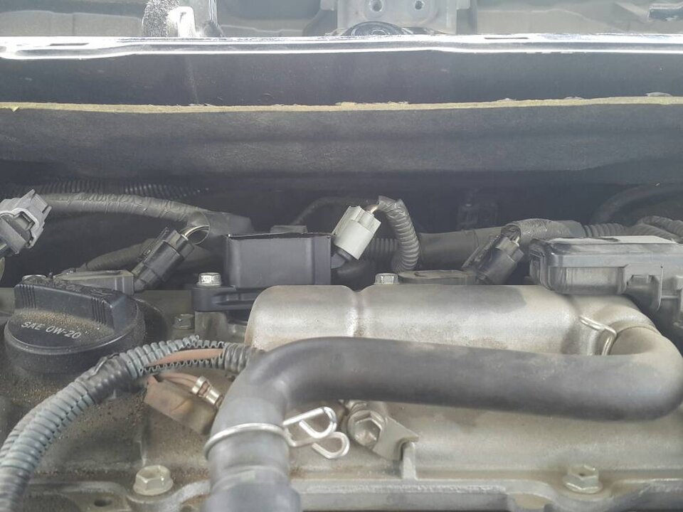

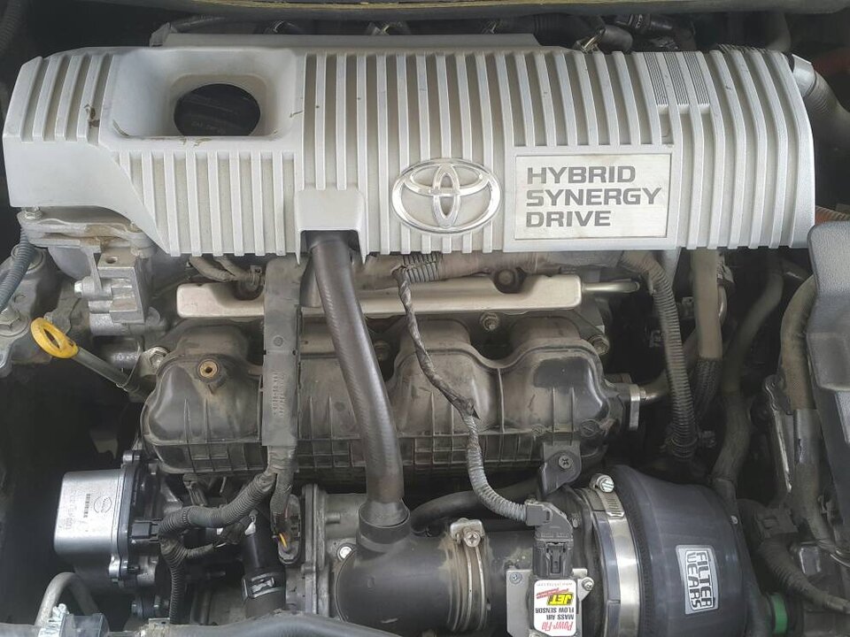

    Been wanting to try these and I finally placed an order since the timing was right.
    As soon as I took them out of the box I felt the weight on them and thought, I have to compare them and sure enough, there was added weight.
    These are designed with the primary and secondary windings at the top versus the standard style.
    The test drive went without a hitch,
    smooth all the way with a cold start and actually required less rpms to get to speed all while doing it faster.

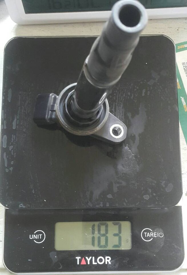

    I was using Duralast ignition coils and there was nothing wrong with them and they have a lifetime warranty.

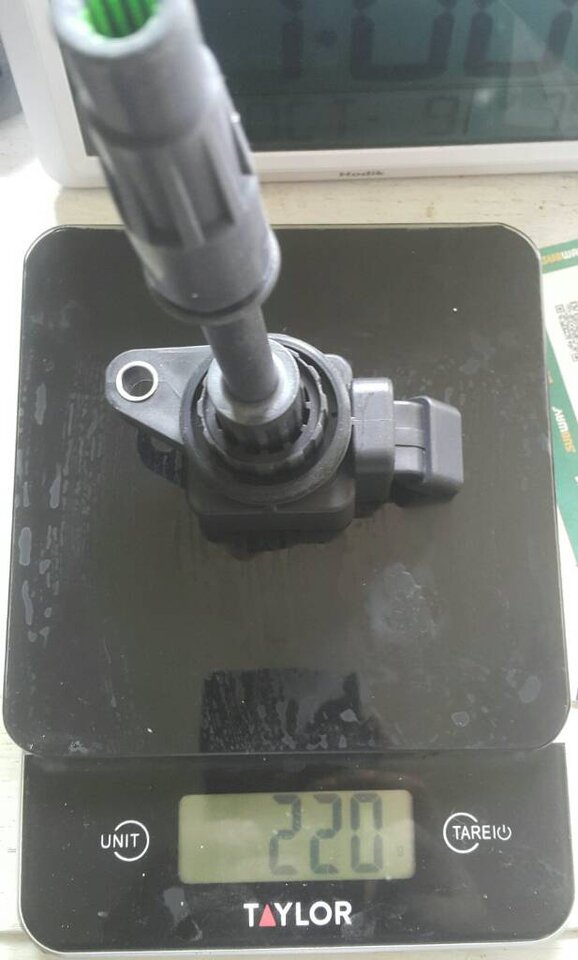

    Duralast weighs 183 grams each coil,
    while the new ignition coil weighs 220 grams each coil, a whole 37 grams more coppers windings than Duralast coils.

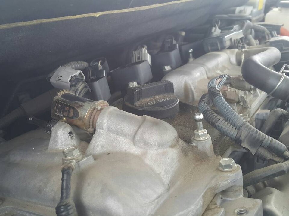

    No fit issue with the bigger coils either.
    Im just gonna run these for a while and see the change, which I already felt and saw on the average mpg display.
    These should run cooler with more power and last longer than a standard prius ignition coil. 20251009_110532-1.jpeg 20251009_110052-1.jpeg 20251009_111038.jpeg 20251009_112658.jpeg 20251009_115725.jpeg

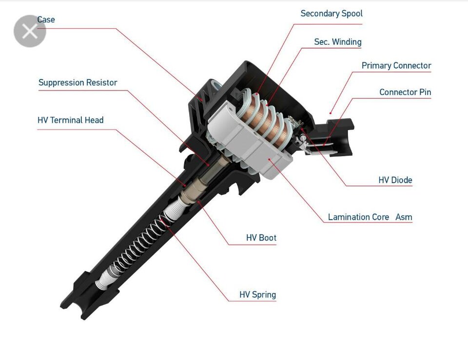

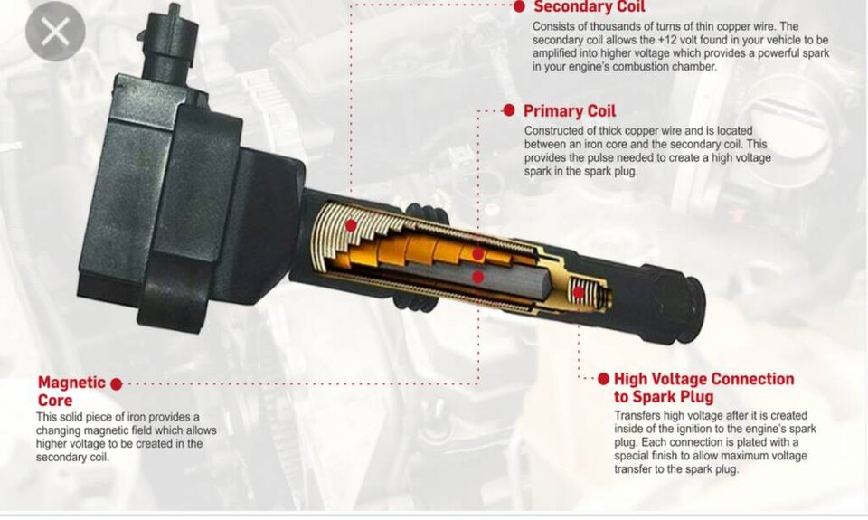

    You seem to have a learning curve so I will show you these two images, that show the difference between the coils.
    Toyota has even changed their coils to these typese in their new gens.
    All Im saying is that I have not changed my driving style or roads taken and mpg is going up.
    Take out all my gear and aluminum skid plate and I would get more mpg than you could and it would be easy.
    First image shows how my new coils are designed.
    Second image shows how all other standard pencil style coils are made.
    This is not a "sales pitch" Im playing
    "Gate Keeper" on these... Screenshot_2025-11-15-08-42-36-1.jpeg Screenshot_2025-11-15-08-42-56-1.jpeg

    Is one of those designs better than the other? What makes it so?

    @ChapmanF
    The main idea is to prevent high heat degradation of the primary and secondary windings.
    Moving both of them to the top of the coil will keep them cooler and provide a longer lasting coil.
    Another benefit to doing this, is the ability to provide 30% more windings providing better power to the spark plug.
    That is why the new coils weigh more than my other coils.
    They just provide better power that is more consistant than stock through out the power band and engine is not as loud.
    Getting to cruise at 50-60 mph @ 1000 rpms is a lot smother and easier.

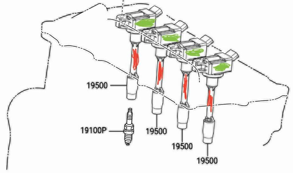

    Now the primary and secondary are in the GREEN, outside and above the valve cover.
    Versus being in the RED inside the cylinder walls.
    The old style is why many coils went bad before their time.
    Also they are able to have more copper in the primary and secondary because of the new design, which gives better power. Screenshot_2025-11-15-12-03-22-1-1.jpeg

    The nice thing about the ECM computing misfire margins is the chance to know whether anything is coming close to misfiring or incomplete firing under any driving conditions.
    Given that there isn't anything else the igniter / coil / spark plug are responsible for, the margins could be of interest to a person wanting to compare them.
