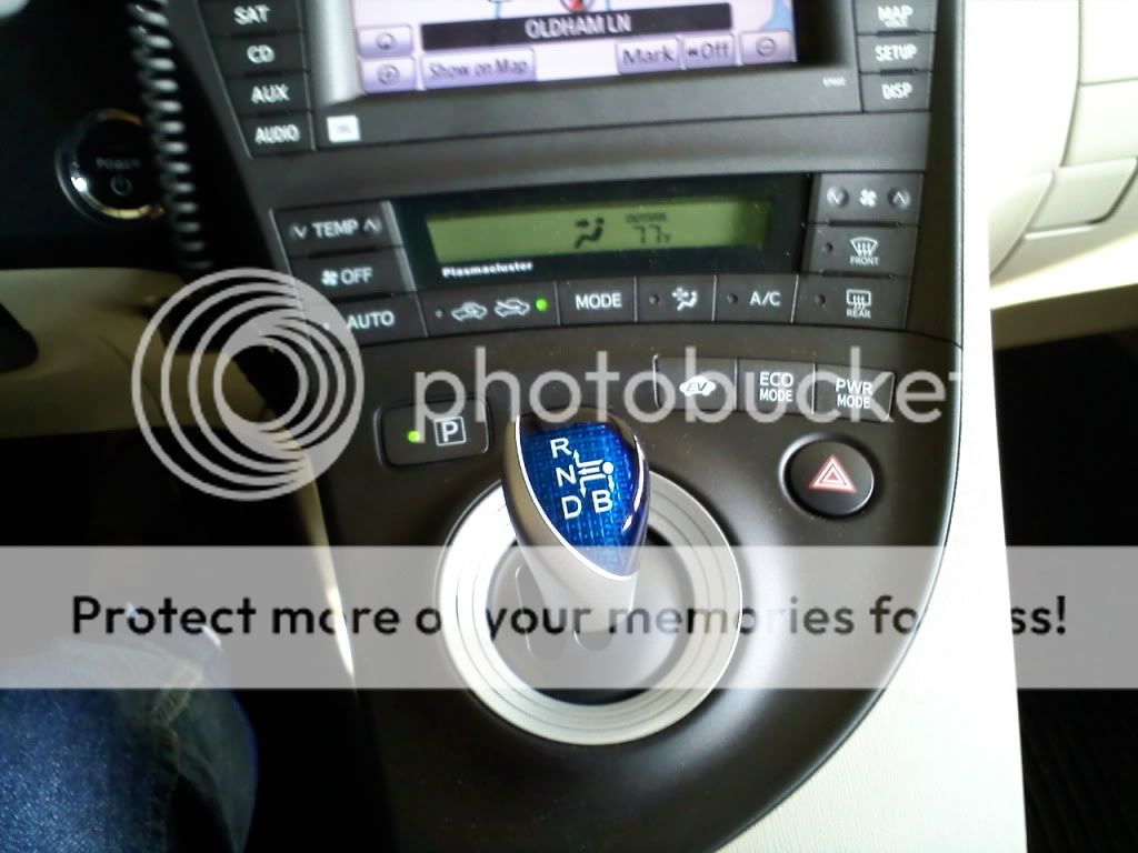

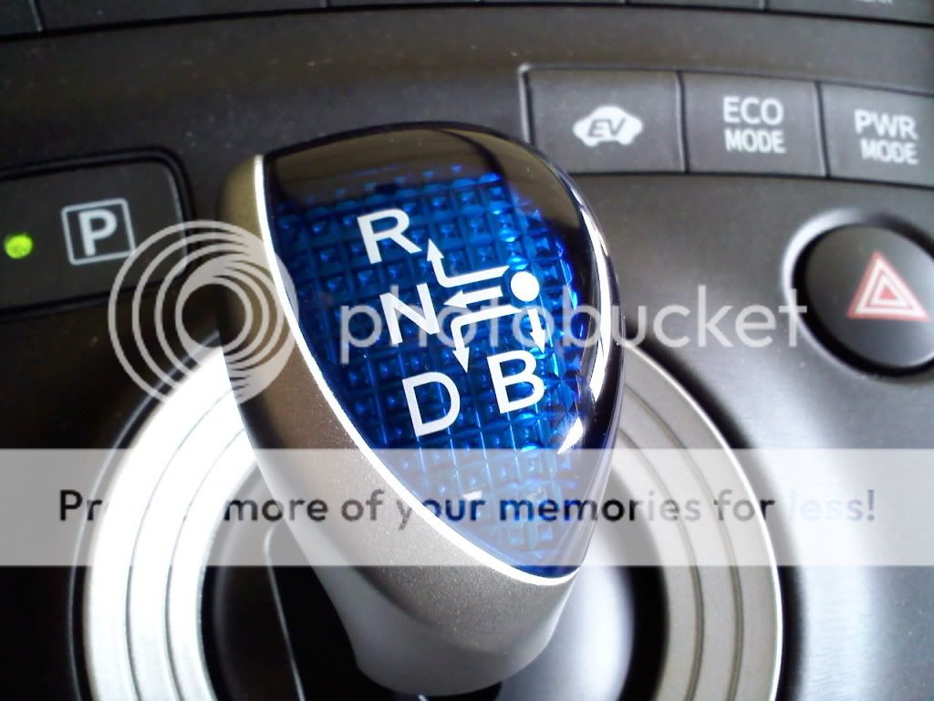

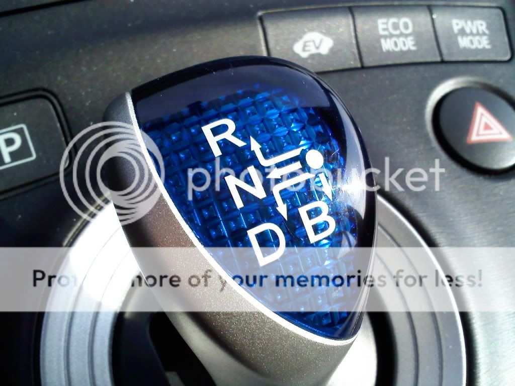

    BTW.. I said i would post pictures of daylight shots with the glowpowder installed.
    I honestly can't tell any difference from stock... so it didn't ruin the daylight look of the shifter if thats what someone is worried about.
    Here is a closeup shot "shaded" without direct sunlight hitting the knob.
    Here is a closeup in direct sunlight "although not real obvious in the pic"
    Here is one more in direct sunlight with the center console in view.
