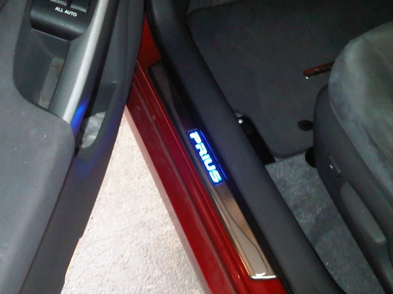

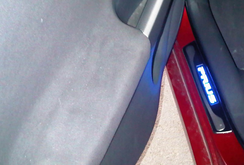

    Here are mine! All are White LEDs. First 3 photos are taken with flash, the last without, need a tripod!!!
    In the last photo you can also see the White LED Lexus footwell bulbs, they all match!!!

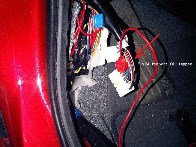

    Last Satuday morning I installed illuminated door sills from autodvdgps.com. I decided to tap the +B 12V power from OL1 (driver side), resp. NL1 (passenger side) pin 24 and use door switches for each door sill as a switched ground. This +B pin is powered from DOME fuse, so there is a good match between sill's light and fuse's name. Above mentioned connectors are located under front side kick panels - see Pic.1 below.
    For the installation we need to remove front and rear door scuff plates. Then partialy detach the front and rear door weather strips along the center pillar and then the lower center pillar t-shaped cover can be removed.
    The rear sidebacks (on passenger side with battery vent) can be placed out without the rear cushion removal. The 12mm hex screw (one on on each side) is accesible with long wrench through the niche between rear cushion and sideback itself. The push of the sideback slightly up will remove it and the rear door switch is accessible. Then the front kick panels have to be removed (1 plastic nut and 2 blue plugs).

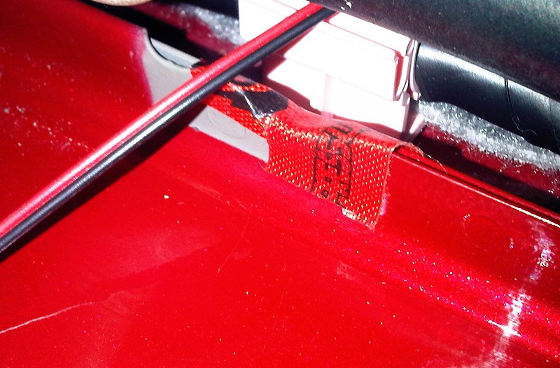

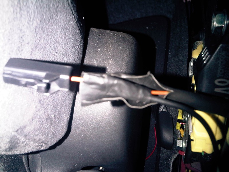

    I simply soldered the additional wire to each door switch wire and insulated the joint with the tape and repaired the original wire tubes.
    Each sill has a wired connector and its corresponding free cable with an opposite connector. The sills are designed for the double side tape installation, which I don't like. So I mounted stainless sills over original plastic ones. It is not perfect fit, as this 2 piece assembly is higher then OEM, but sills can be easily removed in case of necesity and there is plenty of space between doors and body.
