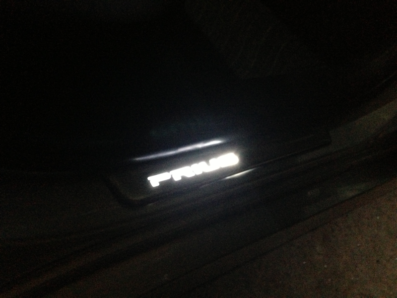

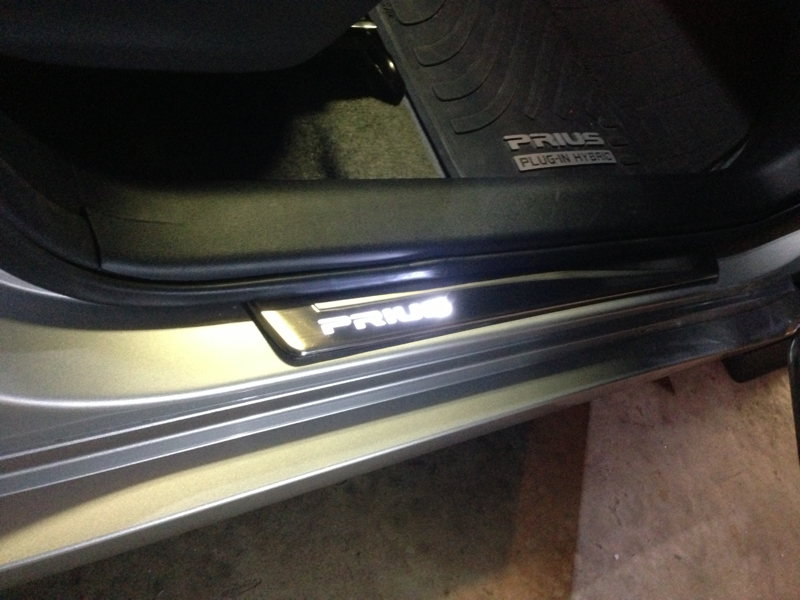

    I installed my illuminated front and rear door sills today. Here are my thoughts
    I ordered them from simmi3300 on ebay for 100 bucks. As other posters have mentioned, they sure did stink like oil/grease/something when they arrived. I let them air out in my garage for a few days before I did the install.
    Overall, I don't think I would recommend buying these over the OEM Front illuminated only sill plates. While having the rear door illuminated is nice, I felt the quality wasn't there. Specfically, you need to stick them on top of your existing plastic door sills to make a good bond. Even then, they are not exactly "stuck" to the plastic and seem to pop up a little. I'm not sure what the long term durability will be, but I could imagine the front of someone's foot popping them off.

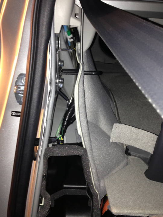

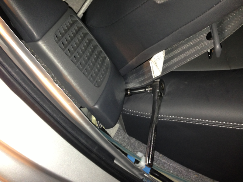

    • Rear installation you want to remove the side cover so you can get access to the door switch. Do this by removing this 12mm bolt
    • Which then you can easily see the door switch to tap into:
    • It's the green wire. You'll tap that into the black wire on the harness.

    Here are some (craptacular) pics.
