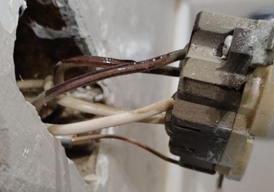

    Kinda of on-the-run here, but pix were requested along with size. Here goes:
    Box is about 1.75 inches across by 3 inches long (45mx80mm, loosely) and 2.75 inches deep (70mm)
    The wires are "backstabbed" and there is no real slack in the wires once I pull the outlet from the box, what you see is what I have -- can't pull it out any further.
    Do not know how I could access the ports I need to free the backstabs, so maybe I will have to try the Stevewoods destruction method on getting the wires out.
    As you can see white wires on one side (right or passenger side looking from headon) and black/purple on the other side (left or driver side looking from head on). Bare ground wire at the bottom.

    I use a paperclip or similar to release the wires. it's a Chinese finger type of connection, so you have to push the wire and paperclip in, then pull the wire out.
    if all else fails, I snip the wire as close to the outlet as possible.
    grab the wire with pliers and wiggle as you pull.

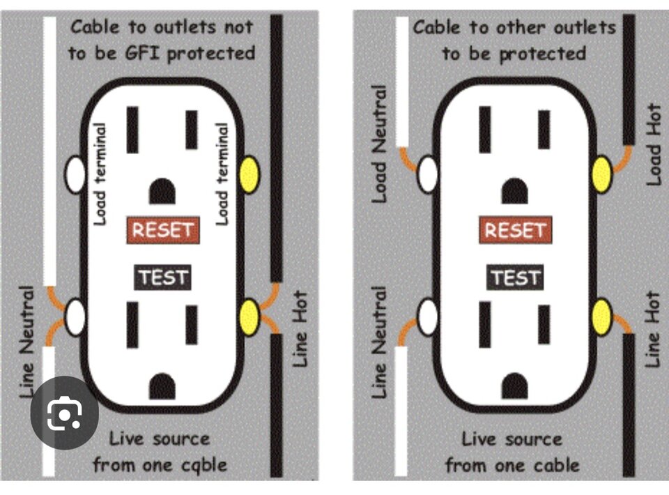

    Second that outlet feeds another outlet or possibly several downstream loads as noted by two blacks and two whites. Not a big problem but installing a gfci there will either gfci protect all loads downstream or will only protect that outlet, depending how you wire it.
    The gfci will have instructions for both.
    Right pic protects downstream loads. Its the one I would use.

    Labeling would not help if you are installing a gfci.
    You have to find the pair that has 120vac on them with the breaker on.
    They go on the LINE side of a gfci.
    A point I tried to make twice above.
