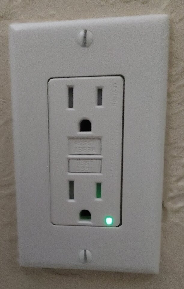

    I keep kind of an assortment of cheap thingies around for testing which wires are live. A multimeter, sure, but also a little pocket-clippy neon light with test probes, and a similar thing with 'gator clips, and some of those funky light-bulb sockets made for festoon lighting, where you just screw the back of the socket down over some wires, and maybe two or three other things I was turning over in my hand one time or another thinking "that might be handy in some situations to see which wires are live".
    So, like, I could turn the breaker off first, and take the old receptacle out, and stick the top black/white pair into one funky festoon socket and screw the back down, and stick the bottom black/white pair into another funky festoon socket and screw the back down, and put small light bulbs in both of the sockets and go flip the breaker back on and come back and see which light bulb lit up.
    If there were no toddlers around, I might just switch off the breaker, remove the old receptacle, and leave both pairs of wires sticking out of the box, bent well away from each other, go back and turn the breaker on, and come back and poke at the exposed wires with the pocket-clippy neon light with test probes.
    But I don't think I would do it that way with a toddler around.

    Maybe the local hardware store knows a licensed electrician that will do work after hours for less. Get the whole circuit protected by the first gfci or put a gfci breaker in is what I would do, with all new spec grade outlets at least. An arc fault afci plus a gfci is even better, may be required. It definitely needs replacing from what you said and the picture.

  12. rjparker
    rjparker Tu Humilde Sirviente
    Jun 6, 2008
    10,985
    6,886
    Texas Hill Country
    Nice. Complete with a green light and vertical screws.
  13. Stevewoods
    Stevewoods Senior Member
    Jun 10, 2014
    664
    1,247
    where I am
    Did you use the "lever edge" outlet?

    Well, have not seen Kris around, so I suppose she could have come to a "shocking" end or is enjoying the summer with the dogs and rug rats.
    BUT, I have had an outlet in the guest bath that is also loose and also probably should be GFCI. This an older house & over the years I have replaced most of the wall plugs; this one is one of the last 1960s era outlets left here.
    Anyway, I used the new Leviton Lever Lock and it was easy-peasy.
    Going to be a lever lock/WAGO guy now.

    . I wish they weren't white only.
  18. ChapmanF
    28,612
    18,947
    Are you talking about the MGFT1, MGFT2 families?
    In Leviton's catalog I see a bunch of colors....
    Stevewoods likes this.
