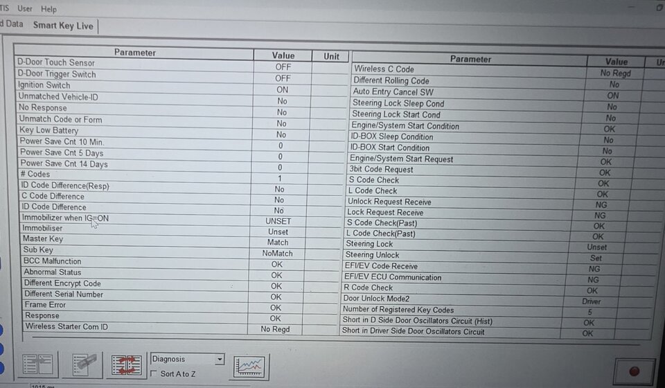

    Please see the data list attached.

    I know nothing about this issue in the Prius (had it occur in the Honda), but I note in your scan page ‘Master Key = Match’ and ‘Sub Key = No Match’ and ‘Number of Registered Key Codes 5’, and wonder whether those plus the ECU mismatch are important hints.

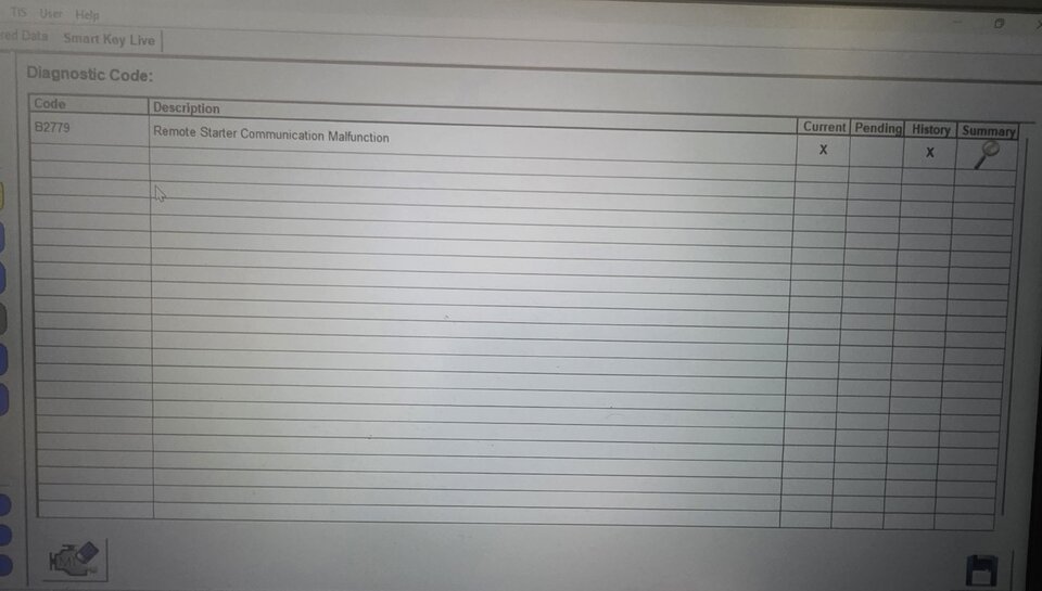

    I also see that # Codes=1. Did you do a Health Check to look for codes the car is reporting?

    Yes, B2799.

    Do you mean B2799?
    Is that the only code the car has?

    You are correct, B2799.
    That's the only code.

    I just checked again, it seems B2779 is correct.

    Code B2779 Toyota Description
    When an internal malfunction occurs in the Certification ECU (Smart Key ECU Assembly), the Certification ECU (Smart Key ECU Assembly) stores this Diagnostic Trouble Code (DTC).
    B2779 Toyota Code - Engine Starter Communication Malfunction
    What are the Possible Causes of the DTC B2779?
    • Faulty Certification ECU (Smart Key ECU Assembly)
    • Certification ECU harness is open or shorted
    • Certification ECU circuit poor electrical connection
    I would try to determine if the remote start is OEM or aftermarket. If it is an aftermarket kit, I would remove it from the car.
