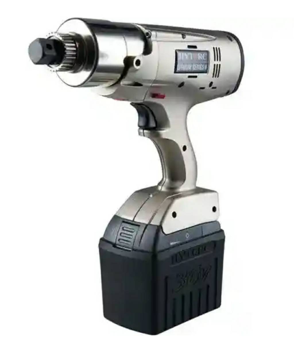

    There are about a dozen different varieties of thread-locking compound, from easily removed on micro screws all the way up to
    "don't even think about trying to get this loose" -
    - some require primer
    - know which product you apply
    Torque technology continues to evolve. A company called hytorc for example has a torque gun that will allow you to apply over ½ ton ft lbs, for example, with just one hand. iirc, about five years ago our company paid over $20K for one of these bad boys + attachments.
