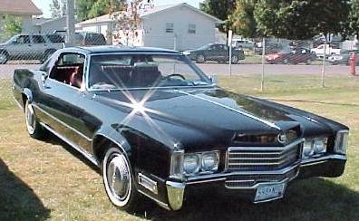

    I think the el dorados of the year had a hood scoop, and I think an eldo hood will mount to a fleetwood front clip. will look into it.

    turns out the eldos didn't have a hood scoop. I will ask my programmer about getting a fiberglass one, and making a scoop similar to what was on the earlier GTO's.
    el dorado.
