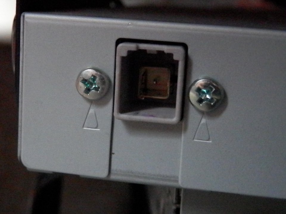

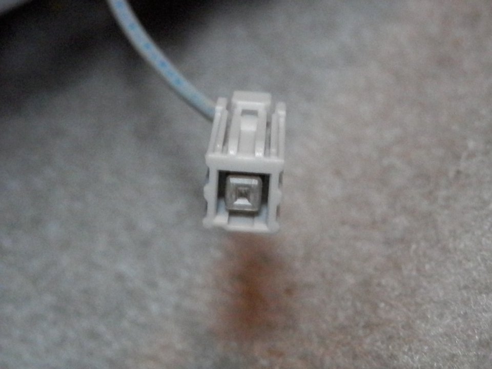

    I took GeoGeek's advice and picked up the Terk XMicro2 from Amazon. I was initially worried because we subscribe to Sirius, and I wondered if there would be a compatibility problem. But after splicing and soldering we get Sirius without interruption! This post saved my subscription!

    I have a 2011 Prius III that brings the JBL radio. Its not the Navigator one. My XM antenna goes straight into the radio in the back. I bought one of those Terk Micro2 antenhas because the stock one wasnt working. I couldnt get XM audio for more than 15 seconds. The connections on the Terk was not the right one so I had to cut the cables and solder them together. Now I have perfect signal with no drop outs. I dont have a tuner box under my seat. All thats there are air bag modules.
