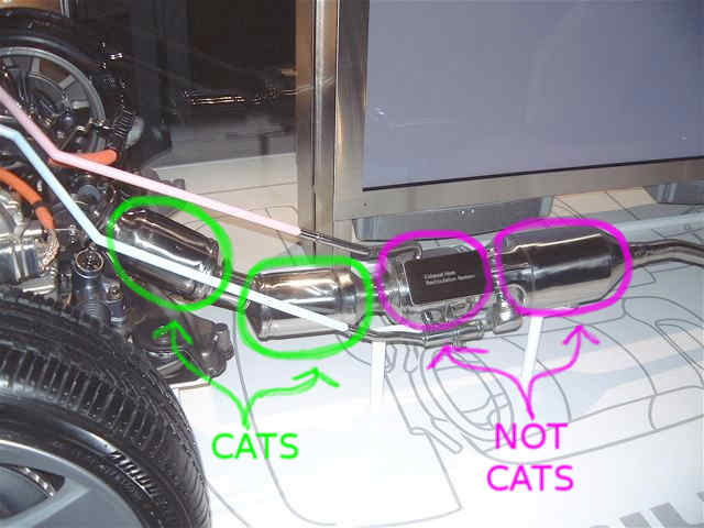

    I had my Gen 3 done this morning. It took only minutes and they didn't even have me get out of the car.
    Because I knew the number of bulges (not all of them catalytic converters) might be confusing, I printed this out to hand them before they started. It is specific to Gen 3, but maybe we can prepare versions for other generations too. The guy who went down in the pit originally didn't take it down there with him, and then he asked for it before he got started, so apparently it was useful. ;)
    I have not slithered under my car yet to get a look at what they actually did.

    Yesterday I did. It looks like they got the spray paint on both cats (and some on the EHRS, for good measure), but only engraved the second cat. (The first one is pretty hard to reach from down there, at least without taking some covers off.)
