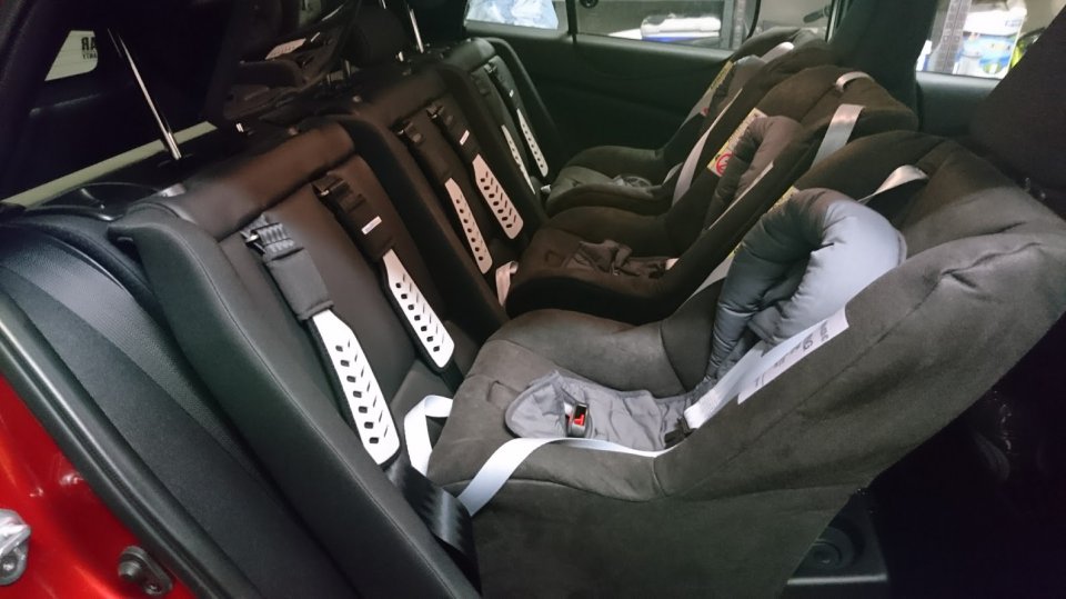

  18. wjtracy
    wjtracy Senior Member
    Sep 19, 2006
    11,374
    3,609
    Northern VA (NoVA)
    Of course (see below) or search on "Triplets!" god blessed them

  20. Wuzki
    Wuzki Member
    Nov 23, 2017
    101
    34
    los angeles
    It does not look like a Prius prime to me, this is a normal Prius....... there is no air vent on the side!
