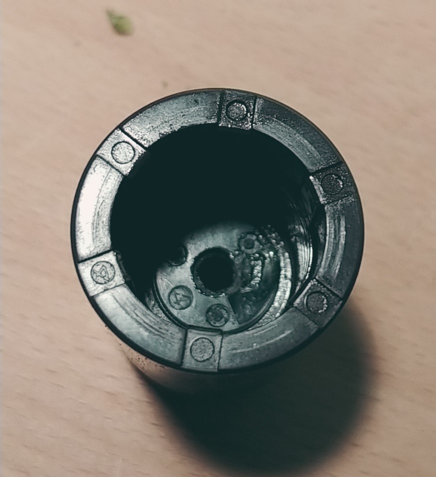

    All of that is symtomatic head gasket failure, coolant in the combustion chambers. and EGR cleaning, while always commendable, will not "fix" it.
    Just guessing, the persistent P0401 code may due to damaged internals in the EGR valve. This:

    What's circled in Mendel's image above is an UNdamaged ski jump. A damaged one has a rut in it, like this:

    Pics of EGR valve are very helpful. I had it apart when cleaning the EGR loop and the pin springs back but didn't know to check the "ski jump". Seems possible that it is bunged up as the car has 150K miles on it.
    Hoping it isn't the head gasket. My guess is that the EGR loop was pretty plugged up, but it was a coil that went bad that caused the death rattle. I've been watching the coolant level since cleaning out the EGR. Hasn't moved after burning through 3 tanks for gas, nor has there been any sign of a rattle at startup (or anyother time since replacing bad coil), or white vapour out of the tailpipe. I have not pressurized the coolant system to check for leaks though. Apparently Canadian Tire has the kit as a loaner but I don't really trust myself to run the test accurately.
    At any rate, a bad EGR valve "ski jump" seems most likely to me. Is it foolish to do this before pressurizing the coolant to check for bad gasket? And am I correct that changing the valve requires removing the wipers, tray, and entire EGR cooler?
