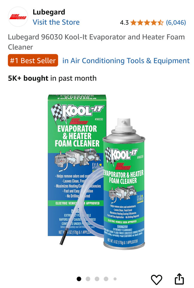

    The Toyota kit retails for $30 - the dealer might pay $15. Amazon's best selling Lubegard 96030 evap foam is $15.
    5000 people buy it per month. Your experience is not unique.

    Sending a demand letter from a lawyer could be pricey if it goes to court, they win and you forced to pay their costs.
    Sounds like way more risk than a $15 diy or a $99 local dealer evap clean.
    Particularly if that is all you really need like the 5,000 others that bought a can of foam last month on Amazon.
