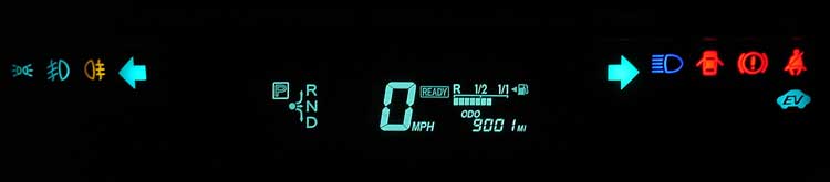

    I installed the Coastal EV today, and it seems to work I guess, I don't get any indicator light on the dash and I know I saw a picture posted on PC that showed a EV mode indicator was already built into the panel and would come on when activated???
    Was this only on Japan models with factory EV? Or could I have messsed up?
    The only indication I get when I do get it to work is that when the battery falls down low, it will do the 3 beep thing and the ICE kicks on. This makes me think it is working but with the coastal EV we won't get a little light indicating it is on like the READY light or something?

    The EV indicator on the dash is only on those cars that come with an EV switch installed at the factory (ie EU and Japan).
    Also, the EV function was not available at all on the classic

    I can show you a picture of the indicator (far right) but you only get it if your car wasn't for the NA market.
