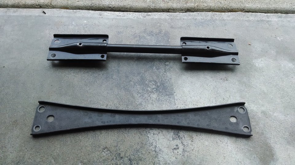

    Yes, very strange how the cusco power brace although seems harmless in your mind, caused such a big change in comfort. I think the decrease in ride quality comfort was like 4x worse compared to installing my new coilovers. I have almost the same setup as you (your CT rims' rubber probably has higher sidewalls), plus coilovers and the car is comfortable and sporty. It is a pleasure to spend the entire day in.
    I was going to buy the cusco rear end brace, and the front end brace as well. After the experience with the center power brace, I am going to leave the car alone...no more braces.

    Hello Grren4ever,
    I've had tried Tanabe Front center brace (stiff/rough/butt pounding), then the CUSCO power brace...it was o.k with the stock 15" rims and tires and it makes the car stable on highway at high speed, then I upgraded the CT rims the car doesn't comfy at all even with the correct factory tire pressure at 33/32 psi, tried all kind of psi setting still not comfy. So...we (family members) start hated to ride in it then I figure that reverse to stock one piece at a time, right on spot it is the CUSCO power brace, took it out and sold it on Ebay for $120, now with the updated stock rear center brace we enjoy riding the car much much more now, I already put 100k+ miles on it since March 2011 and it still drive like the day I bought it, plus I changed the spark plugs and it's now silky smooth drive.
    You have a better/lighter rims than the CT rims, about 7 lbs lighter which is almost the same weight with the OEM 15" rims, the tires that came with the CT rims are 215/45/R17" same as yours winter tires, I set my tires in the early morning inside garage 33.5 front and 32.5 rear, I am average 45+mpg calculated (not from the MID). No more mods for now.
