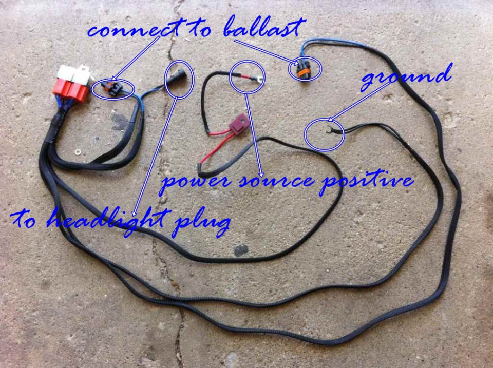

    Anyone know how to install the relay harness that comes with the Morimoto kit? Not sure how to get power to the relay.
  17. ImeanGreen
    ImeanGreen Prius v Five BP Brigade #236
    Feb 20, 2012
    547
    73
    Somewhere out there
    The red wire with fuse should be connected to a constant power source(positive). See foglight install. The black wire goes to ground. There will be 2 short wire plugs and 1 long wire plug. One of the short wire plug will be connected to the wire harness that supplies the power source to the headlight bulbs. You should not make any mistake here because the wire harness that plugs into the relay harness will be a male or female socket - will only fit one socket. Obviously, the shorter wire harness from the relay should be located near the constant power source which will be the driver's side and the long wire harness from the relay kit will go to the passenger side headlight.
  18. U2NVME64
    U2NVME64 Junior Member
    May 12, 2013
    77
    25

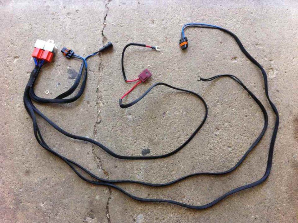

    Okay I found my power source in the fuse box (Good thing). But in putting it all together before installing, I still come up with an extra female plug from the relay (Bad thing). Anything to do with electricity is my weak point, am I just a dummy and can't figure out the obvious? This kit is soooooo frustrating!!!!!
  19. ImeanGreen
    Feb 20, 2012
    547
    73
    Somewhere out there
    You only need the drivers OEM harness to plug in to the relay. The passenger OEM harness to the headlight will not be used. You need to tape it good so water won't get into it. Here's a photo for reference. Connect your wiring harness from headlights male plug to female plug of relay harness, relay's male plug to female plug of ballast and ballast male plug to female plug of HID bulb. I hope this makes it clear. See photo for reference

    Okay now it's making sense. There was a lot of extra plugs and things that I wasn't sure where they went. The install instructions from TRS is pretty much garbage. They should remove it because it just complicates things. Thanks so much ImeanGreen, huge help!!
