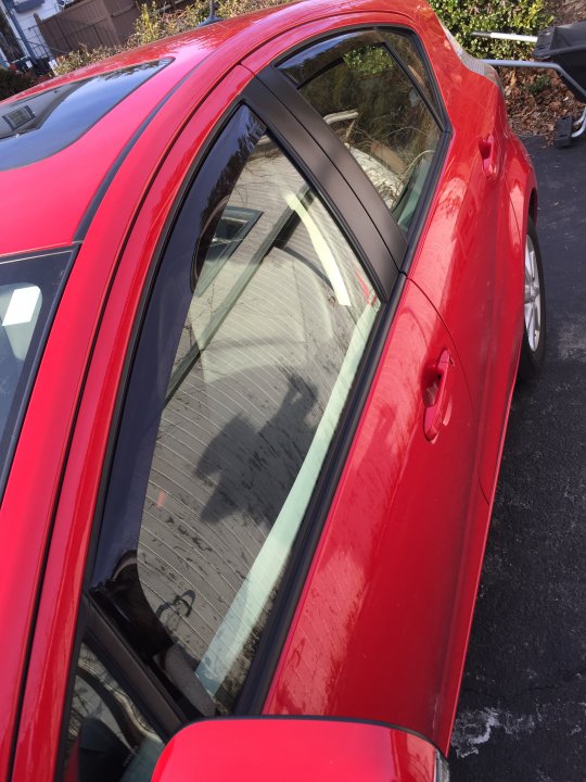

    Thanks for the warning. Any pictures of how the rear windows look?
    These are the weather tech. Had a set in my last 2006 Prius, never scratched or cracked. They are even better in my 13C-4
