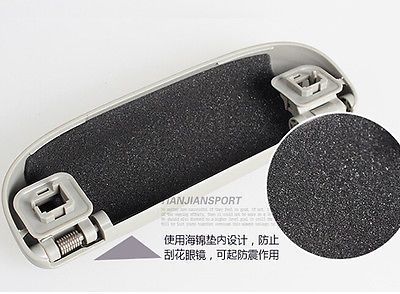

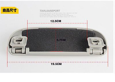

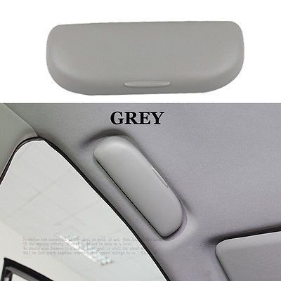

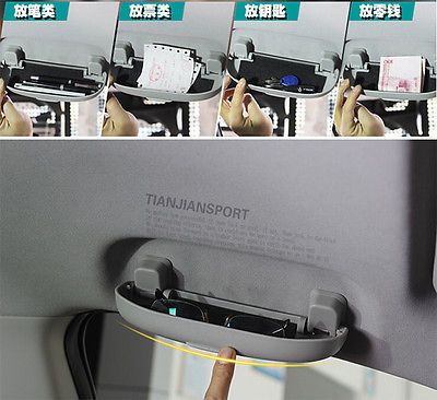

    So I searched for a suitable part and bought this off eBay, even though the description said it’s meant for non-US market Corolla / Altis models. For less than $20 shipped, I figured if it didn’t fit the Prius I would either try and adapt it, or I wouldn’t be out much if I had to toss it.
    http://www.ebay.com/itm/231714270880
    (Or, after this particular auction listing expires, just search eBay for the term “Corolla Sunglasses Holder” and you’ll find it.)
    Seller’s pics:
    It arrived, shipped direct from China, less than a week after ordering it (much faster delivery than promised by the seller). It fits! And the quality is good -- it has a spring loaded hinge, a nice foam insert, a nice little chrome trim garnish, and the light gray color is a good match. Sorry, I did not take photos of the installation job in progress, as it is literally so simple and easy that none are really needed:
