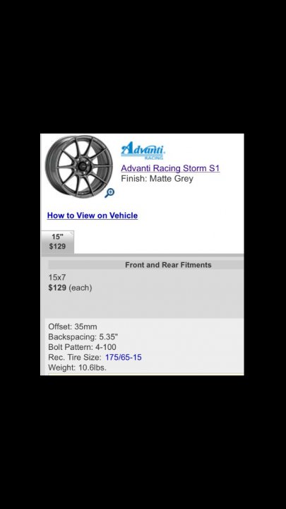

    image.jpg I was looking at these 10.6 lbs for $129.00 Has anyone been down this path? Any feedback?
    Manfred Melloh and Danger Dang like this.

    Hey guys! KKim, I recognize you from the 250 ninja forum! Anyway, I'm no stranger to the wheel/tire debate as a former manager of a tire shop. Although more of my knowledge comes as an enthusiast looking for more performance whether it be grip or MPG.
    So, in short, I've found a 24lb setup in a Enkei RPF1 14x7 +28 (8.6lbs) and a Kuhmo Sense tire 185/65/14 (14.7lbs). Total weight is 23.3lbs. BUT, that particular setup has an unfavorable offset at +28 that would stick out too far concerning aero but IS the lowest weight option out there.
    Next option is more preferable to looks/performance/price but adds a bit more weight for the Advanti Racing Storm S1 (15x7 @ 10.7lbs) and the Kuhmo Sense 185/60/15 (15.7lbs) for a total of 26.4lbs. My worry here is that it would also stick out a bit much (approx flush up front) and start causing some aero turbulence.
    So, next on the block is some 14x6 +38 Kosei K1TS that wiegh 9.3lbs and the Kuhmo Sense 185/65/14 (14.7lbs) for a total of 24lbs. This setup would be tucked under 15mm more than the S1's listed above and keep me happy in the aero game while being notably lighter.
    Of all these options, I like the last one as the K1TS is priced right at $119 a wheel through tire rack and has a reasonable offset at +38 for a 14x6. Sure, it would not be a performance upgrade really in the looks or handling dept, but would be best for overall cost and MPG improvement, which is frankly what I'm looking for. Although I really feel drawn to get the Advanti Storm S1's for looks! Plus, they're a popular wheel with the Miata guys giving me resale options later!
    Problem is none of the sites I frequent can give me the best case scenario of free ship/no tax and free mount/balance as nobody carries these both other than tire rack which wants $110 to ship them from Nevada to CA. =( I wonder if they'd use my shipper number for me? I could get it down to half that I'm sure!
    Ok, I will assure you that 14" wheels do fit on the "C" but they just won't look very cool.
    Alright, I've blabbed on enough for now. But, and I WILL say this, I REALLY don't feel that lightweight rims/tires are as big of a difference on a hybrid for MPG as on a non hybrid in the sense that the extra energy used to motivate the heavier wheels/tires to turn can be somewhat gained back through regen. BUT, it is still important, and the added benefit of increased acceleration when needed would be welcome. And regardless, the handling will improve with aftermarket tires.
    The THING to look at is the weight of the tires, not an LRR designation. Weights can vary between 15-20lbs in the sizes we're looking at for the C. As MUCH as I'd LOVE to get some ultimate grip, that would put me into a wider (205mm) 20lb tire which I simply cannot do to my fuel economy. I have a 500hp Subaru for that game. The Prius C is ALL about the MPG. =)
