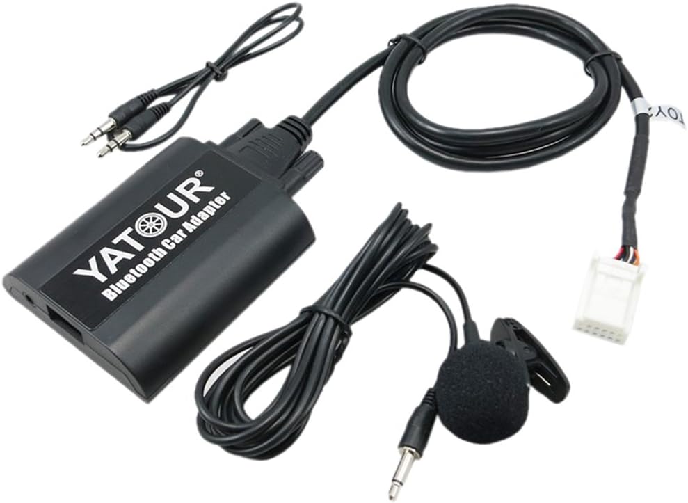

    So I tried to go the "cheap" route and get a bluetooth device to plug into my AUX in, long story short once I solved the engine noise problem on the speakers, the microphone was doing it too. I wish I had just got one of the Bluetooth options for about $50-$70 like this:
    It could be that the 3.5mm jack causes the audio issue, and maybe a bluetooth link wouldn't be so low.

    For me the ground loop isolator did a great job of eliminating the noise, but only for the output to the speakers, my microphone still sounded bad to the other party on the call. And that was kind of my point that rather than doping what I did and needing to chase down noise problems with cheap solutions, it might be better to get the one that hangs off the Stereo CD changer port that doesn't rely on external 12V connection.
    So far I have this:
    3.5mm Car AUX Bluetooth Wireless Stereo Audio Music Receiver Adapter USB Charger 655887889011 | eBay
    This noise isolator:
    https://www.crutchfield.com/S-geAsbb9V9Ui/p_127SNI135/PAC-SNI-1-3-5-Noise-Filter.html
    So I figured I need a power filter/isolator on the 12V cigarette lighter outlet. I hope that fixes it, but I'll end up spending about as much as the one that plugs into the back of the stereo and gives you steering wheel controls over Bluetooth. So I don't recommend my route that's all.
