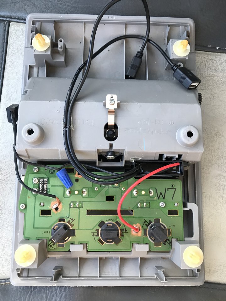

    I hard wired a 5v usb charger powered from the dome light circuit board.. There is a lot of copper to connect to, scrape the coating away and solder or screw your leads to it... Then I ran a small push button so I could cut the constant power source if needed...
