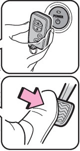

    If your model V is equipped with Display Audio, there is another way to disable/enable SKS on page 117. Go to Setup -> Vehicle -> Key System with Elec. Key, turn Off / On.
    After the SKS is disabled, the push button start will not work. To start the hybrid system, apply the brakes and touch the emblem side of the electronic key to the "Power" switch and press the "Power" switch within 10 secs.
