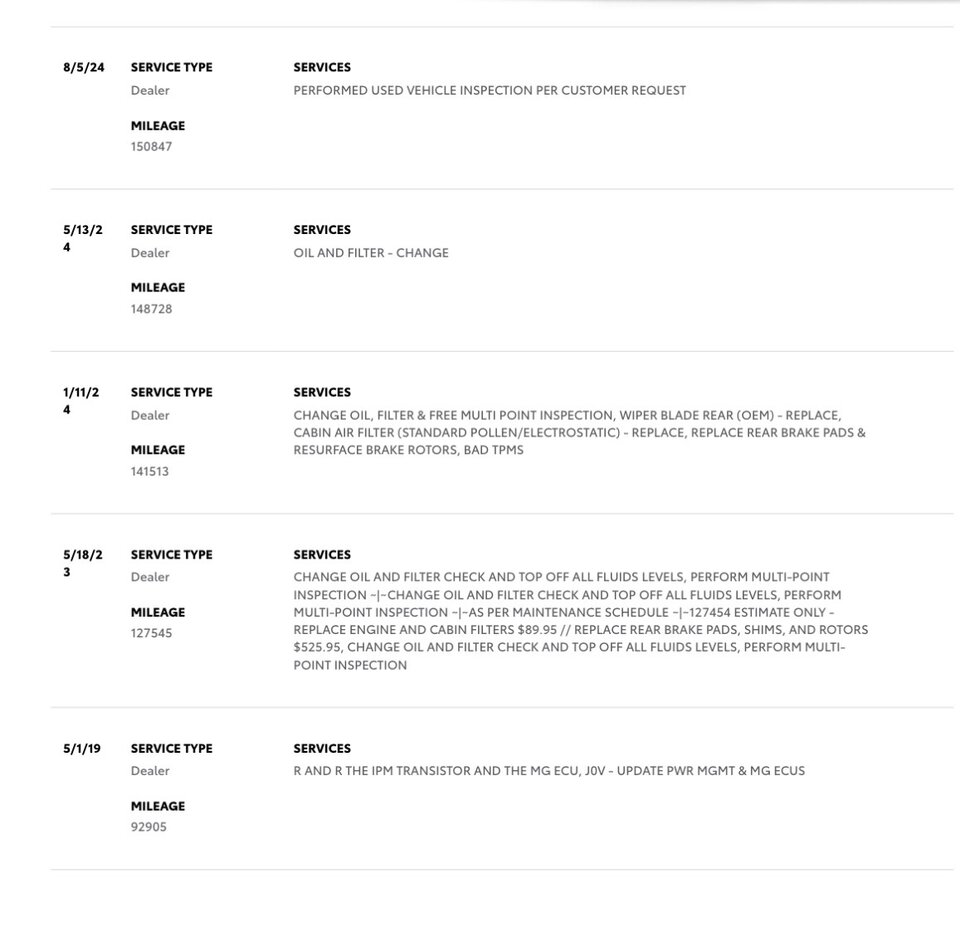

    Aside from whats in carfax (not much detail) and the paperwork from a body shop that did some work last year, nothing really.
    The original owner had it from 2013-2024 and the most recent owner had it for about a year, and he didn’t do much aside from regular oil changes and an alignment.
    I will be checking the hybrid battery fan this week to see what condition it’s in. Fingers crossed it’s pretty clean :)
  11. bisco
    115,508
    52,891
    you can log into toyota.com/owners with the vin for any dealer service history
    ksyolsen likes this.

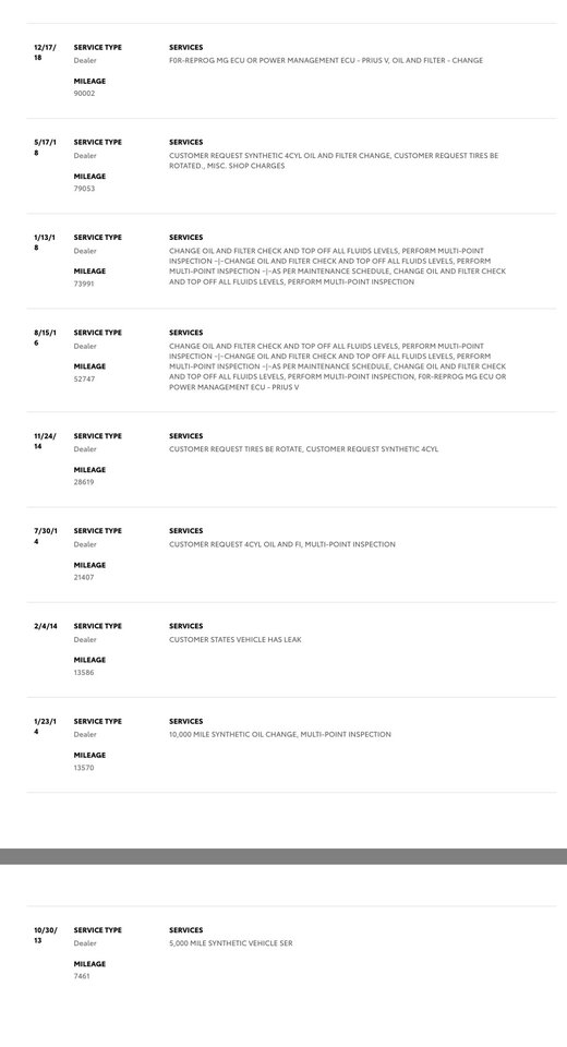

    Oh nice! Thanks for that!
    heres what they have:
    seems like they really went through rear brakes, especially with the condition they were just in when I did them. They were down to 1mm on the back.

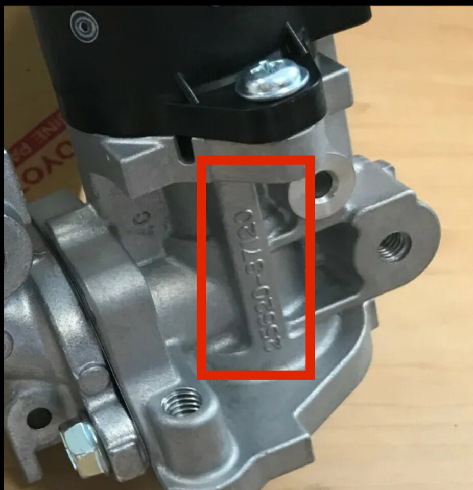

    Decent pricing. Hopefully the tariff "surcharge" is not too bad. People I know who have it shipped direct end up paying ups or usps the tariff directly on receipt.
    A genuine oem egr valve will have this part number embossed in the valve body:
    An older version will have another part number; the aftermarket valve will have no number.
    Toyota online stores have there biggest discounts around major holidays.
