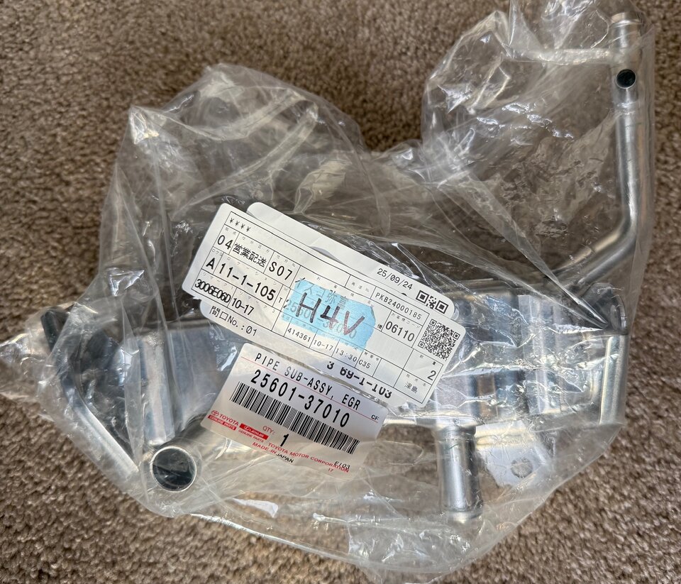

    EGR Cooler from eBay Japan arrived as well

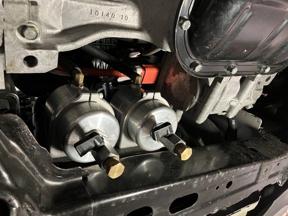

    I went “upmarket” some on my OCC, have dual Moroso 85474 Air/Oil separators. They’re pricey though, and getting more so.
    Lots do mount by the drivers headlight; I opted for below the intake manifold, on a bracket atop lower cross beam (front jacking point beam. They’re bottom draining, most practical access during oil change:

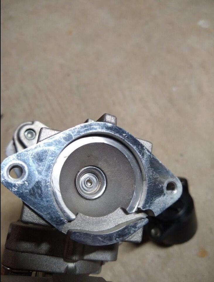

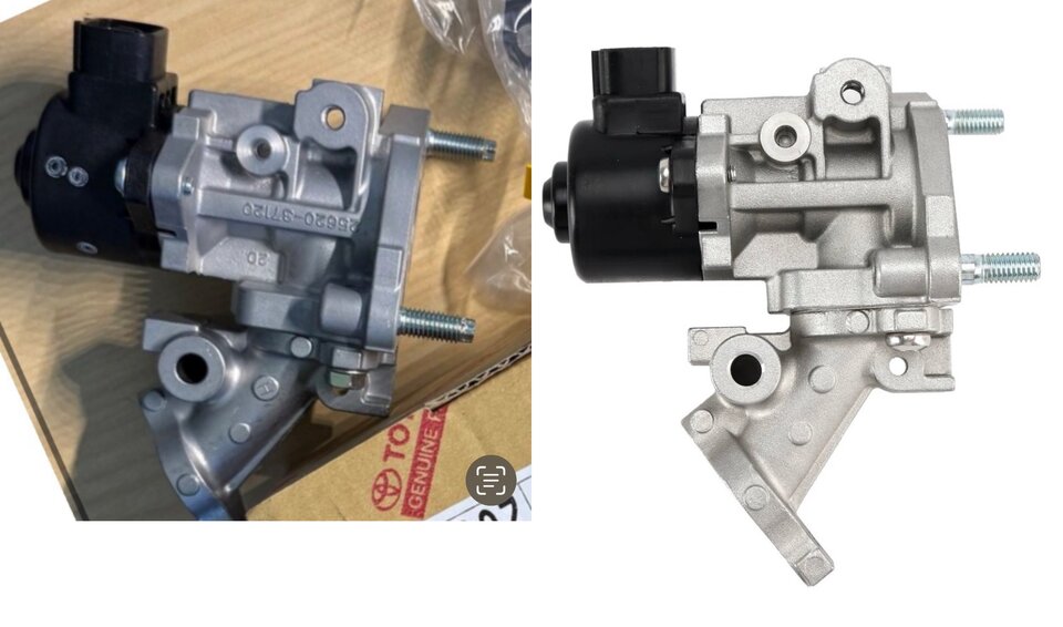

    The comparison I keep wanting to see is how the revised Toyota valve compares inside to the original Toyota valve.
    So far, everybody who has bought one of the revised ones has been like, "not me, I'm not opening the cover on this valve I just bought!".

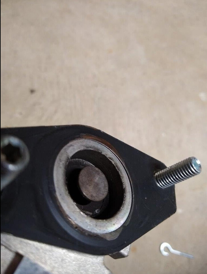

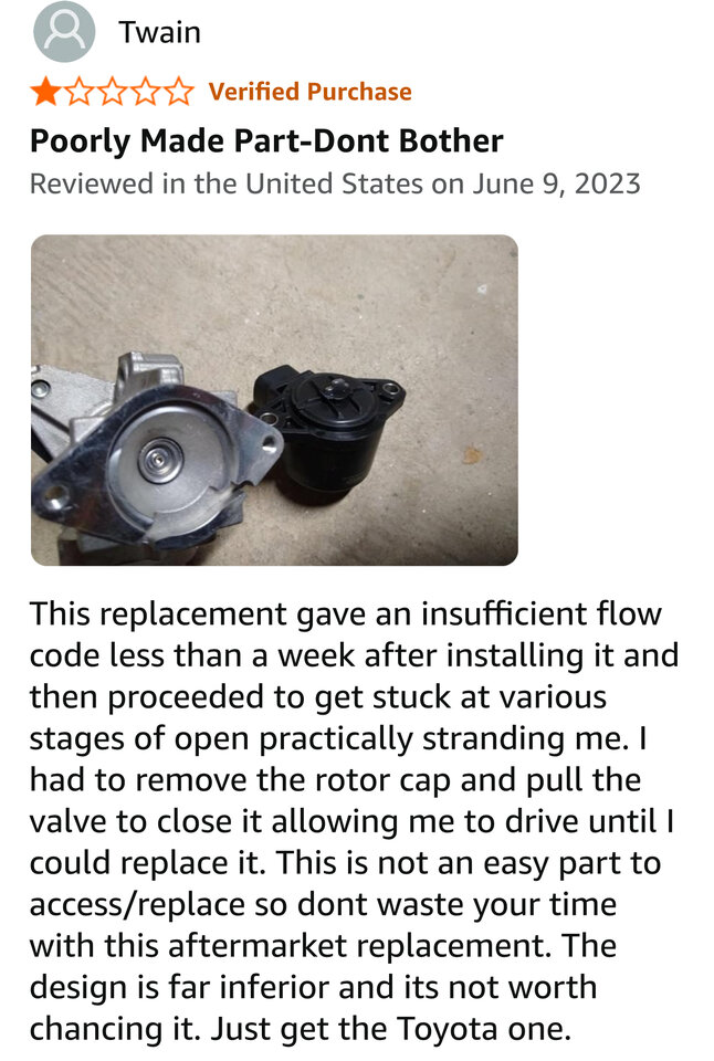

    I tried one once and it took a no code original egr to a P0401. It would stick open right out of the box. I did not take it apart to avoid trouble returning it. It went back and the updated Toyota version went in.
    From an Amazon review:

    Yeah, that's the inside of a cheap knockoff. We've seen those before.
    There is a genuine Toyota-issued update to the original Toyota EGR valve. We know it's physically a bit larger and the wire harness needs to be untaped a little for the plug to reach.
    That's the one I'd be interest in seeing inside pictures of.

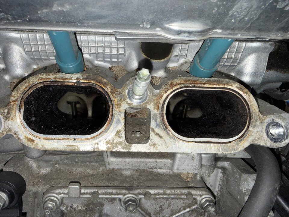

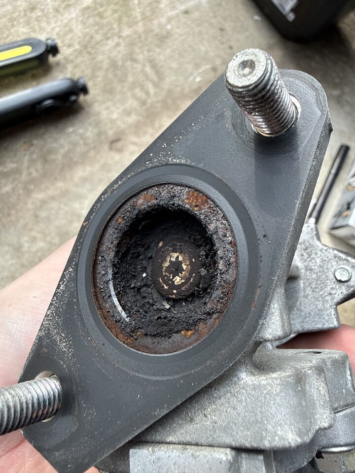

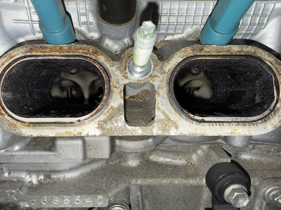

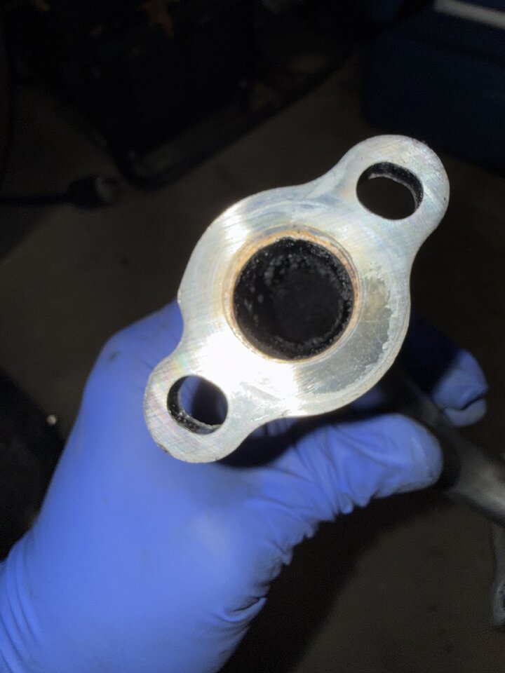

    Started at 9:10am and it’s 12:30pm now.
    I’ve got the intake and EGR Valve and cooler out, new PCV valve in.
    Cleaning up the EGR pipe and intake a bit then a lunch break before putting the new EGR cooler and valve in and hopefully getting to some of the other stuff.

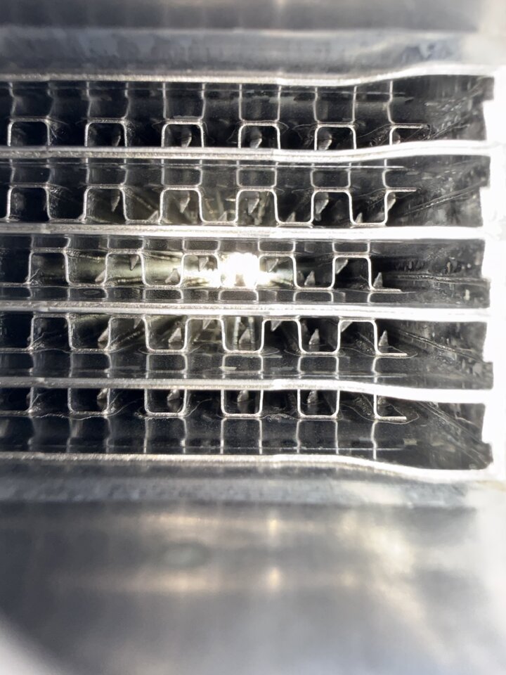

    there was a pool of oil in the intake and the EGR cooler isn’t clogged fully which is good! I can still see light through the passageways. But the parts have clear buildup so I’m glad I’m doing this.

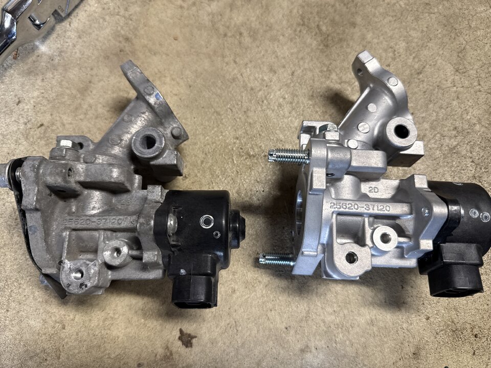

    Existing EGR Valve appears to be the updated part number.

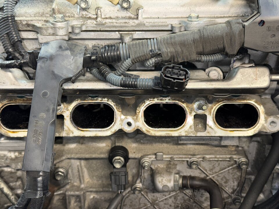

    Well exposed pic of the intake manifold's mating face would be good.
    Try to take note of gasket orientation as they come off: all the metal gaskets at the EGR components have dimples around the central hole, can be dimpling one way or the other, still go together, but maybe not one direction is optimum?? Not explained in Repair Manual, at least the copy I've got.
