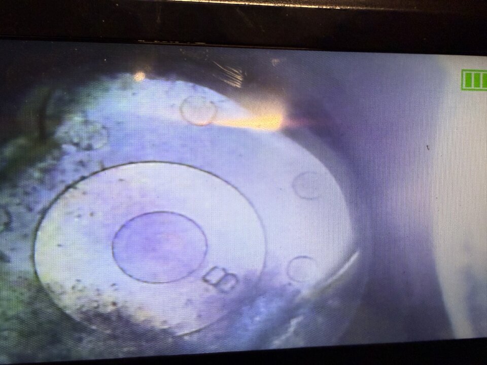

    So far, the oil level has yet to drop, but will continue to monitor. I used a bore scope camera when the old spark plugs were out and the pistons have some carbon but were relatively clean, almost suspiciously so, but it was hard to tell and i haven’t had experience looking at many others so I could just be paranoid about the HG.

    Here’s an image from cylinder 2 iirc, I didn’t take pictures from the others as the spark plugs were all similar condition so I figured I’d see the same thing in them all, so I only looked in 1 and 2 before just swapping the other plugs out

    That looks a little too clean.
