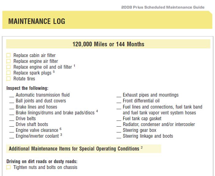

    My maintenance manual says to "inspect" transmission fluid at 120K.

    What is Toyota's idea of "vehicle life" and how does that expectation compare to your idea of reasonable vehicle life?
    If you are happy to get 150K miles out of a car, then I agree that you don't have to worry about replacing the transaxle fluid. If you strive to log more trouble-free miles then some preventive maintenance would be justified.

    In Minnesota cars last about 200k, then start to die due to rust. Many die before, a few last a bit longer. A WS transmission failure is rare compared to T-IV and Dexron III transmissions of yesteryear, across all Toyota models, but you are correct in saying it isn't going to hurt anything.
