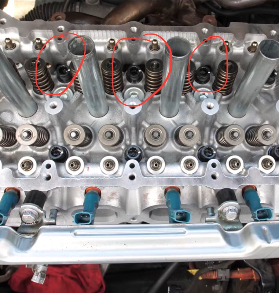

    We have a 2012 Prius. Recently did a bunch of work on our Prius. Long story short, had to take it to the dealer because we couldn't get in running correctly.They discovered that one of the valve stem caps was missing and could not locate it. All of them were installed and everything was torqued to specs when the I replaced the head gasket. Sooooooo, where could the cap have vanished? Could it have landed on top of one of the pistons? Is there an oil passage from the top of the head to the oil pan large enough for the cap to pass through? Any other thoughts? Your help is sincerely sought and appreciated. Will be going to the dealer on Monday to see what the options will be.

    It was left out during the hg job or it was loose and fell somewhere in the engine bay when the dealer tech opened it up. Either way it was not installed properly.

    I don’t think it’s possible, if you look at my cylinder head, everything is closed off and too small for the caps to move past those holes. My best guess would be it got lodged into the head bolts top hole and is in there if it moved around some how. But I don’t think it’s possible for the caps to go into the top of the piston since the one way it’ll go into the piston would be through the spark plug tube. You would also definitely hear some engine issue if it’s on top of the piston.

    #9 rjparker, Aug 3, 2025

    I see it now, it’s on the exhaust side of the head. :ROFLMAO::ROFLMAO::ROFLMAO:
    well dang, I hope you can find it, if not, just remove the oil pan to see if it’s down there or not. I would just pull the head back out and replace the missing valve stem caps.
