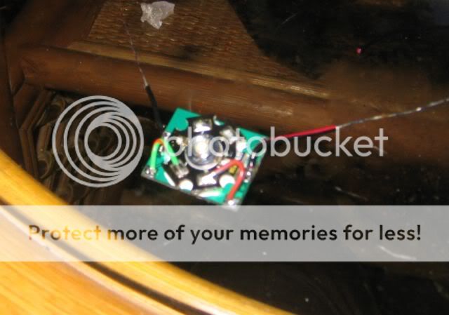

    Found some on ebay already actually, under "1W LED" search. I'm sure you have seen these before, and they point the wrong way for most Prius applications, but still kinda cool...

    I'm always curious to see what others are coming up with. The picture you posted above raises more question than it answers though. Looks like the circuit consists of a resistor and diode (sort of a poor-man's regulator which can work pretty well). My main concern is with heat - depending on drive current. There appears to be no heat sinking, and I'd worry about the gap temperature. I'll have to do a bit of research here!
    I actually *am* starting to sell these things now, though I haven't officially announced it since even without really saying anything, I've got about as much business as I can handle. Once I get all my materials lined up, I'll probably make an official announcement and see how it goes.

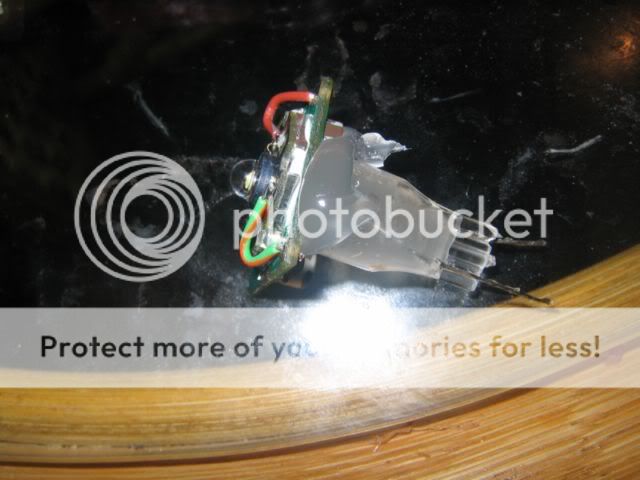

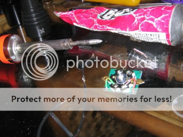

    I decided that this would be a fun learning project so I got ahold of a CC1W dome module and made a dome replacement out of it.
    I found the required tools: A regulator board, the plastic dome blank thingy, some wire, and shoe goo
    Then I soldered and tinned the leads, I will just use the long tinned leads as the conductor wires:
    Heres the part where it gets fun. Shoe goo!

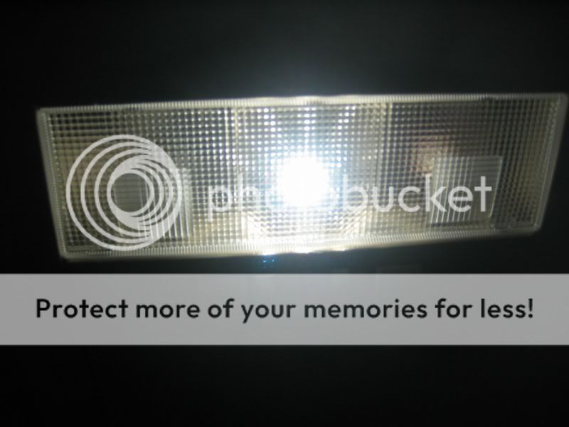

    Installed and tested:
  19. darelldd

    Atta boy. The one thing I caution you on is the goo connection from the board to the bulb base. With a few minutes use, the board will be plenty "warm" and it may soften the goo enough to cause a problem. Or not. Don't know for sure, that that prospect concerned me enough to use thermal epoxy just to make sure things stay where they should.
    Beats the heck out of the incandescent, eh? You only have eight more to go! :)

    I'll keep an eye on the goo to make sure nothing bad happens, its still drying.
