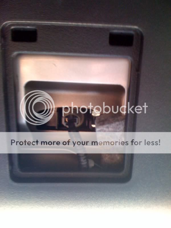

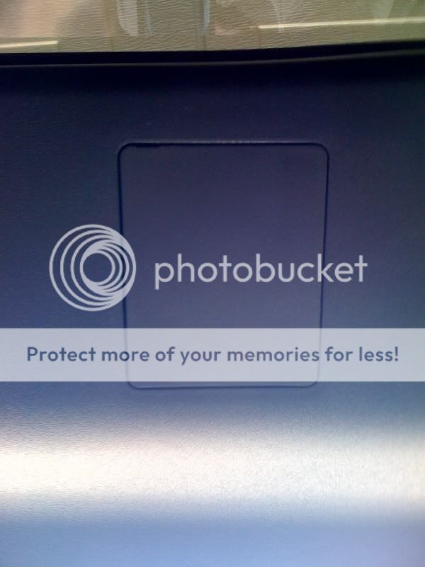

    Just finished replacing a bunch of bulbs on my (and my wife's) Prius and wanted to say thanks so much to Antiflash for the part numbers and to Paradox. Things went much smoother than I thought they would.. Was a bit scared changing the map lights - pulling down the center console was somewhat scary and it seemed like all my snaps let go at once, so when it came down, there was this huge noise and I thought for sure I broke something :) But I didn't. I changed out a total of 14 bulbs across two cars and didn't break a single clip or cover!
    I can't find the thread now, but I thought I saw somewhere here that in order to change out the license plates lights, you needed to remove the whole back panel from the hatchback. It was much easier than that. There are two panels inside the hatch back that pop off. The plastic is pretty flexible, so I doubt you'll break them. I popoped them off from the side with a small screwdriver. The clips are at the top.
    Once those are off, you've got access to the license plates lights. You'll see a wiring connector going to the bulb:
    Unplug the power connector by pressing on either the top of bottom and pulling straight back.

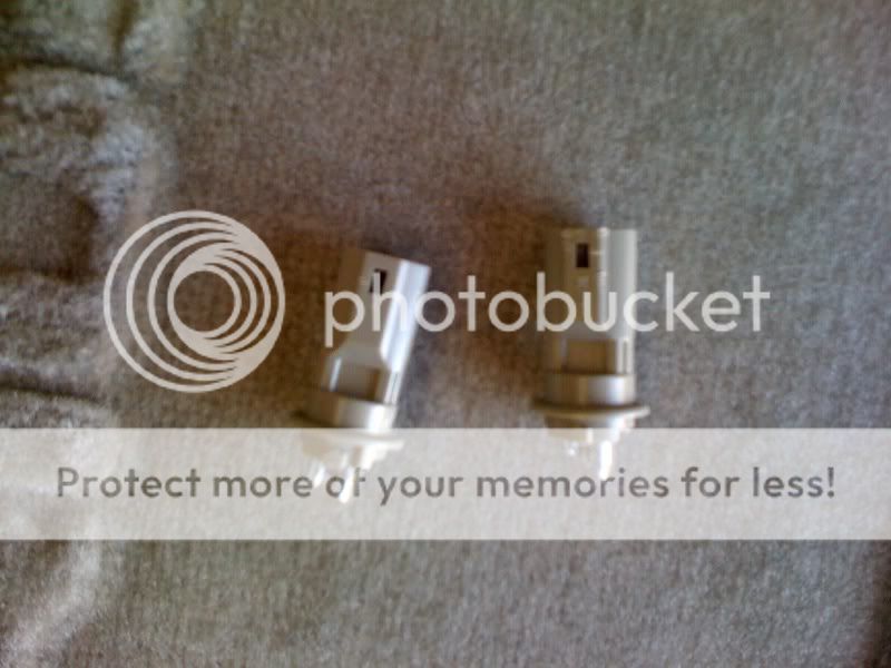

    That gray plastic thing is the bulb housing. I used pliers and took it out by rotating it 1/4 turn counter-clockwise and pulling it out.

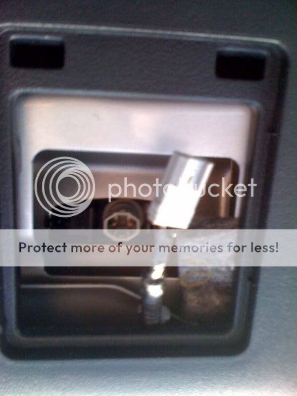

    Remove the bulbs from the housing and insert your LEDs.
    Put everything back together. When putting the bulb housings back in, turn clockwise until you hear then click into place.

    That was on the Gen II, on the Gen III it is very very easy by just removing those 2 plastic covers over where the bulbs are. The Gen II did not have them...
